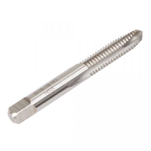

Tap, 5/16"-18, Spiral Point
  • HSS spiral point plug style tap
  • 5/16"-18 threading (coarse)
  • Three flute
  • H3 thread allowance
  • Ground from solid HSS / ground threads
Part Number: 6178
Weight: 0.05 lb
Price: $7.95
Spiral point plug style tap, ground from solid high speed steel (HSS) with ground thread.
Three flute coarse thread, with an H3 thread allowance (plus 0.0010 to plus 0.0015).
The flutes on a spiral point tap are more shallow than those of a conventional tap resulting in more surface area for cutting, making them stronger thereby allowing for higher cutting speeds and less power required for the tap to travel.
