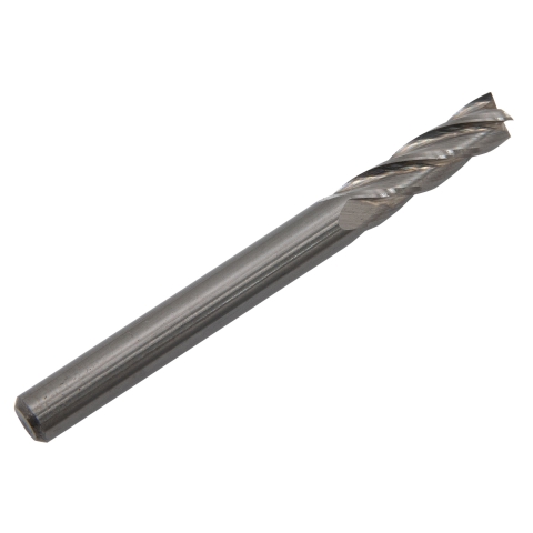

End Mill, 3/16" 4 Flute, CarbideMade in United States
  • Single ended, 4 flute, center cut geometry
  • Designed for increased chip removal rate
  • Used for finishing operation
  • Ideal for milling, slotting, profiling and trace milling
  • Manufactured from premium submicron grain carbide
Part Number: 6333
Weight: 0.03 lb
Price: $13.95
Single end 4 flute center cut end mill made from premium submicron grain carbide. Used for finishing operations. The 4 flute design allows for a high feed rate as less material is removed per flute. Ideal for milling, slotting, profiling and trace milling.
If greater swarf removal is desired, consider one of our 2 flute end mills.
Diameter 3/16"
Flute Length (Loc) 5/8"
Overall Length 2"
Cutting Diameter Tolerance +.000 / -.002
Shank Diameter Tolerance -.0001 / -.0004
Radius Tolerance +.001 / -.001
Run-Out Tolerance .0005 maximum shank to cutting diameter
