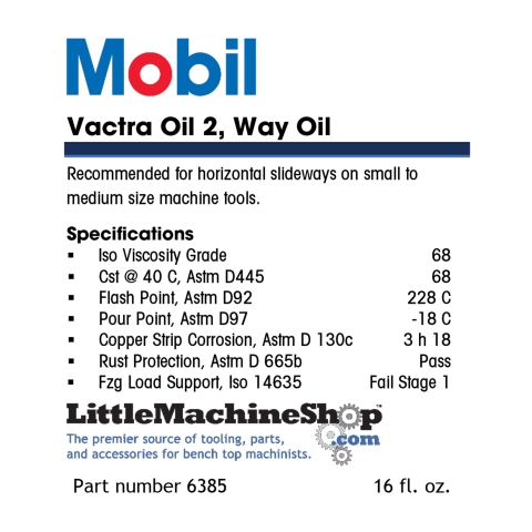

Way Oil, Mobil Vactra Oil No. 2, Pint
- ISO viscosity 68
- One Pint
- Recommended for horizontal slideways on small to medium size machine tools
- Rust Protection, ASTM D 665B Pass
Part Number: 6385
Weight: 1.02 lb
Weight: 1.02 lb
$12.95
Regularly $14.95
When you need oil for your machine, many types of oil will work – even motor oil. However, the best oil to use is oil designed specifically for lubricating machine ways. This type of oil has an additive that helps the oil stick to the surface.
Mobil Vactra Oil Numbered Series products are recommended for the lubrication of machine tool slideway systems. They are designed for use with combinations of cast iron, steel and non-metallic way materials. Mobil machine oil may be applied by hand, forced-feed lubricator or in flood application by circulation system.
Mobil Vactra Oil No. 2 is also suitable for circulating application in large machines and as a moderate duty hydraulic fluid. Mobil machine oil can be used for lubrication of ball screws, linear guides, headstocks, translating screws.
Chris' Tips| Iso Viscosity Grade | 68 |
| Cst @ 40 C, Astm D445 | 68 |
| Flash Point, Astm D92 | 228 C |
| Pour Point, Astm D97 | -18 C |
| Copper Strip Corrosion, Astm D 130c | 3 h 18 |
| Rust Protection, Astm D 665b | Pass |
| Fzg Load Support, Iso 14635 | Fail Stage 13 |
