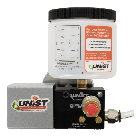

The Coolubricator JR™ is a portable minimum quantity lubrication (MQL) system that is easy to move between machines and is ideal for drill presses, lathes, saws, and open milling machines where manual control and a single nozzle are adequate.
The unit can be hand carried between machines in your shop and easily installed with minimal downtime. The heavy duty magnet on the rear of the unit allows for both quick install and flexibility in locating the lubricator.
This system produces a continuous output of precisely metered lubricants. Air-driven, positive-displacement pumps precisely meter each drop of lubricant at 0.03 cc/stroke. The 100-million cycle pulse generator allows for automatic, infinite repeat cycling of the metering pump. This ensures that a continuous, external film of lubricant is applied to the tool-work interface.

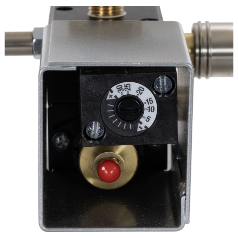

Lets operator easily control atomization of the spray by adjusting air, pulse per minute and liquid metering.
Adjusts output from 4-200 injection cycles per minute with 0.1 to 3.0 drops of lubricant per cycle. A durable, vented 16 oz. reservoir on the CNC mister holds more than 14,400 drops of lubricant.
Dispenses any highly refined lubricant including Unist’s high-efficiency Coolube from the oil mist lubrication system's durable, 16 oz. (0.5 L) vented reservoir.

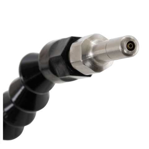

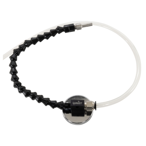

The Coolubricator JR™ combines lubricant and air in a co-axial nozzle tip. The oil mist lubrication system keeps atomization and distribution of the liquid consistent regardless of the hose length. Plastic 12 in. nozzle is coupled with 5 ft. Co-Axial hose. A heavy-duty magnetic base at the hose/nozzle connection of the oil mist lubrication system makes it easier to relocate and position the nozzle at the friction points.

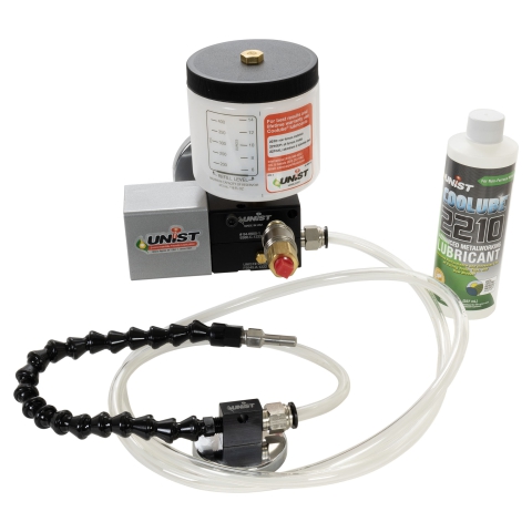

Coolubricator JR Oil Mist Lubricator
1 - 5' output hose
1 - 12" flexible plastic nozzle with magnetic mount
1 - Drop pump
1 - 16 oz reservoir
1 - Magnetic base mount
1 - 8 oz. bottle Coolube 2210 lubricant
