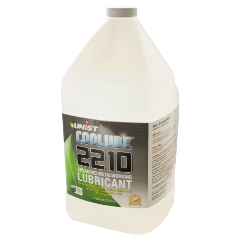

Coolube 2210 Lubricant, 1 Gallon
- Improves performance and increases life of cutting tools, taps, and saw blades
- Increased chip value & production speed
- Eliminates coolant treatment & disposal
- No fluid oxidation (stickiness)
- USDA certified biobased - 100% natural
Coolube® 2210 is a clear natural lubricant that improves performance & increases life of cutting tools, taps, & saw blades. This advanced metal cutting lubricant is formulated as a metal cutting oil as well and as a lubricant for metals, wood, rubber, and most plastics. It is especially effective on aluminum and other non-ferrous metals.
The lubricant is 100% natural, non-toxic, non-staining, and will not oxidize (become sticky or leave a residue). Coolube® 2210 cutting fluid does not contain any ingredients currently recognized as hazardous by OSHA, IARC or NTP. Coolube® 2210 machining oil will never cause dermatitis and is formulated from cosmetic grade raw materials, which makes it entirely worker safe as well as safe for the environment.
