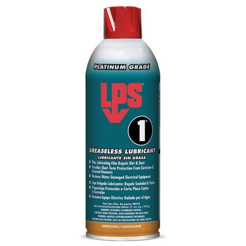

LPS 1 Greaseless LubricantMade in United States
  • Creates a dry lubricating film
  • Resists dust, dirt build-up, and oil
  • Removes carbon build-up and displaces moisture
  • Loosens rusted or frozen parts and fasteners
  • Safe on paint and most plastics
Part Number: 6476
Weight: 0.84 lb
Price: $21.95
Thin, greaseless lubricating film that repels dirt and dust. LPS 1 provides short term protection from corrosion and external elements and can be used to restore water damaged electrical equipment.
LPS 1® has numerous applications in electronics and around the shop or home as a lubricant or to loosen rusted or stuck fixtures and parts.

Boiling Point / Range 415.4°F (213°C)
Flammability lower 0.6%
Flash Point 174.2°F (79.0°C) Tag Closed Cup (dispensed liquid)
Percent Volatile 95 - 96%
Propellant Carbon Dioxide
Temperature Range -60°F to 350°F
Voc Content 0.4% per US State & Federal Consumer Product Regul
Water Solubility Insoluble
