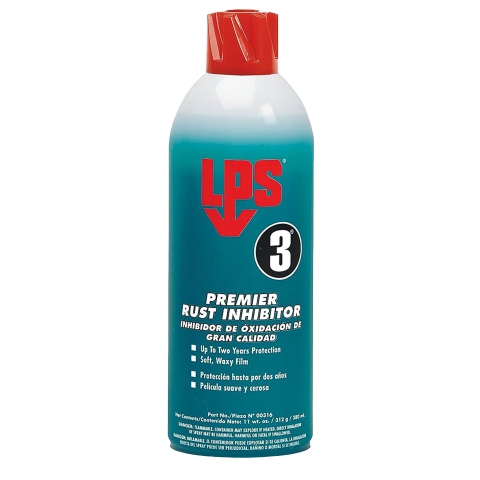

LPS 3 Premier Rust InhibitorMade in United States
  • Prevents rust and corrosion
  • Safe on all metals, rubber, plastics, and paint
  • Provides up to two years of protection indoors
  • Penetrates to displace moisture
  • Inhibits corrosion of aluminum
Part Number: 6477
Weight: 0.81 lb
Price: $28.95
Estimated availability:
Unknown
LPS 3® premier rust inhibitor is a long-term rus inhibitor that protects even in harsh conditions. It lays down a waxy film that prevents rust and corrosion and can protect items for up to two years in indoor conditions. This product is safe on all metals but can also be used on rubber, plastics, and paints.

LPS 3 is a corrosion inhibitor, which is a technical way of saying it stops metal from rusting. You may have heard other terms like "rust preventative", "anti-rust compound" or my favorite “stuff that stops rust” (OK I made that one up). Anyway LPS 3 does just that: it stops the formation of corrosion at points of stress like crevices, welds, cuts, bends, edges etc. on metals. Upon application, LPS 3 forms a tacky waxy film that is both pliable and self-repairing if scratched. Application of LPS 3 can be via spray, brush, or dipping. LPS 3 is perfect for protecting metals inside or out, providing 2+ years of indoor protection and up to 9 months outside protection before re-application is required. It can be removed using solvents such as LPS PreSolve® Orange Degreaser, A-151 Solvent Degreaser, or F-104° Solvent Degreaser etc.
Boiling Point / Range Aerosol: Not Available
Flammability lower 0.6%
Flash Point Aerosol: 64.4°F (18.0°C)
Percent Volatile 63-82 %
Propellant Carbon Dioxide
Viscosity Aerosol: Not Available
Voc Content 62.80%
Water Solubility Insoluble
