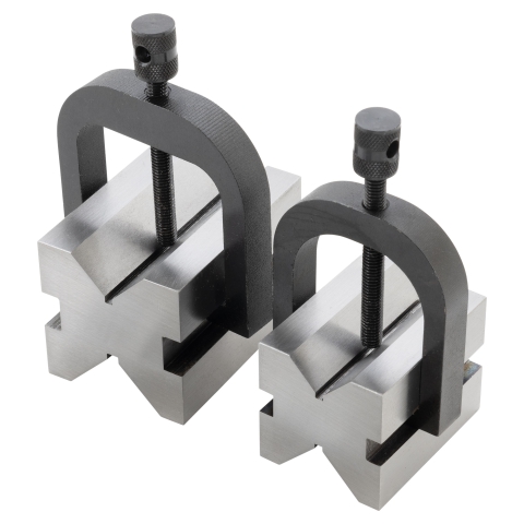

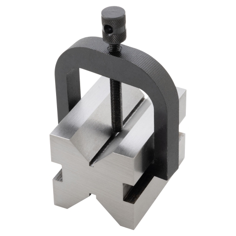

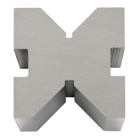

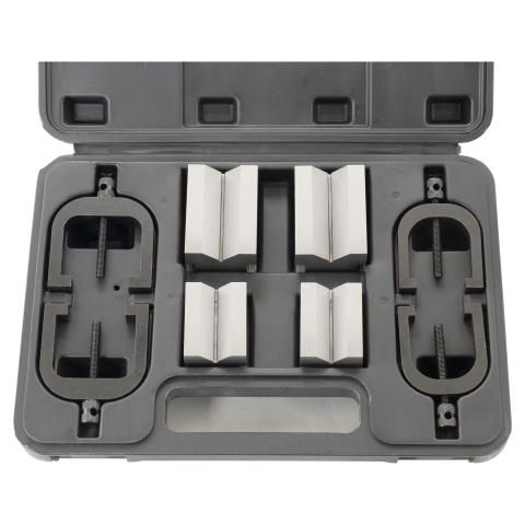

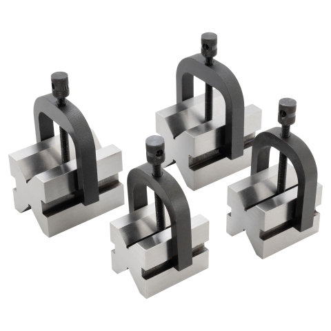

V-Blocks, Set of Four, iGaging
- Set of four V-blocks with clamps in two size pairs
- Square and parallel within 0.0005"
- V capacity per pair 1.5" and 1"
- V-groove angle 90 degrees
- Supplied in protective case
Set of four precision V-blocks are made of hardened steel ground and polished parallel to 0.005".
Supplied in matched pairs:
- Two each: 1-1/2" x 1-1/2" x 1-1/4" (L x W x H)
- Two each: 2" x 1-1/2" x 1-1/2" (L x W x H)
The V capacity per pair is 1.5" on the large pair and 1" on the small pair. Each V-block has a 90 degree V-groove angle.
Set includes clamps for inspection work and is supplied in a protective fitted case.
