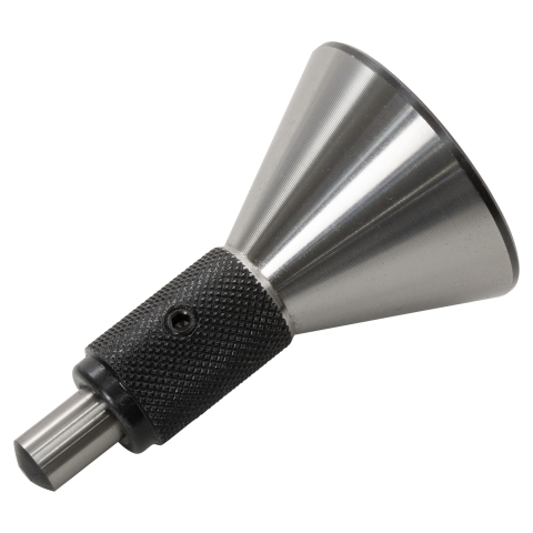

  • A handy tool if with you require precise drilling on round stock.
  • Works on stock up to 35mm (1 3/8")
  • Made of hardened steel - 48-52 HRC
  • Overall length 80 mm (3-9/64")
  • Shank length and diameter 9.5mm (3/8")
Part Number: 6506
Weight: 0.50 lb
Price: $19.95

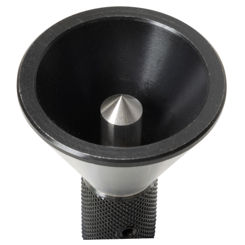

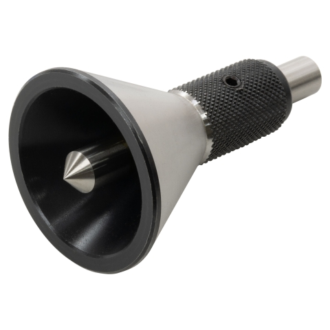

This useful tool allows for center punching of various round stock, as well as ball ended items or spherical work pieces.
Made of hardened steel (48-52 HRC), this punch easily locates and allows center punching on stock up to 35mm (1 3/8").
The overall length is 3 9/64" and it has a 3/8" shank.
The Bell Punch Center Finder is a precision tool used to locate the center of round bars for various machining applications. To use it properly, follow these steps:
  1. Choose a Bell Punch Center Finder that matches the diameter of the round bar you are working with.
  2. Ensure the round bar is clean and free of burrs or imperfections.
  3. Align the center of the finder with the center of the round bar. The interior diameter of bell should make full 360-degree contact with round stock.
  4. Press the center punch down on the round bar to create a hole at the center.
  5. Verify that the hole is centered before proceeding with your machining operation.
