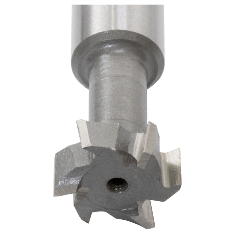

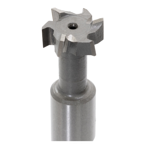

T-Slot Cutter, 5/16" T-slot, HSS
  • For 5/16" T-slots (measured at the top of the T-slot)
  • Cutting diameter 21/32", cutting width 17/64"
  • Neck diameter 21/64 shank diameter 3/4", bolt size 3/8"
  • Undercut length 39/64", OAL 2-11/16", 6 teeth
  • Positive radial rake, right and left-hand spiral
Part Number: 6539
Weight: 0.15 lb
Price: $19.95
T-slot cutting tools are designed to make T-slots in tables and beds.
Two milling cutters are required for milling T-slots, an end mill and a T-slot cutter. A 3/8" vertical slot is milled into the piece so that the neck and shank of the T-slot cutter can enter.
Our high speed steel 5/16" T-slot cutters have positive radial rake, right and left hand spiral with alternate side cutting teeth for maximum chip clearance.
