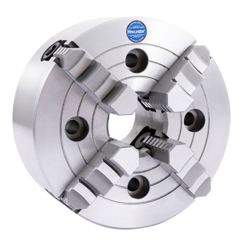

  • Independent 4-Jaw lathe chuck
  • 6" (160 mm) diameter
  • Radial runout maximum of ≤ 0.002" (0.05 mm)
  • High quality components for enhanced wear-resistance
  • Includes chuck key, reversible jaws and mounting screws
Part Number: 6547
Weight: 19.9 lb
Price: $224.95
Estimated availability:
Unknown
PayPal Credit
Harlingen 6" 4-Jaw independent Lathe Chuck front mount. The Harlingen chucks have similar specifications to our other lathe chucks in terms of clamping range however they have a better performance characteristics and the material construction of the chuck is better. The runout of these chucks is rated at ≤ 0.002" vs ≤ 0.003" for other chucks in this class.
The body is entirely made of wear-resistant semi-steel No.40/No.45 (ASTM) providing a higher hardness at HB190-220 compared to other brands using HT250 cast iron with hardness of HB180-220. High quality No.35 (ASTM) is used to achieve higher accuracy, strength and extended tool life. Competitors use HT150 cast iron or engineering plastics as a substitute.
The scroll is made of hardened and precision machined 5140 (ASTM) to enhance wear resistance and strength. Scroll face threads are processed with high accuracy CNC machining which improves self-centering performance.
Jaw are made of hardened carbon 1045 (ASTM) steel. The jaws are pressed individually to ensure precise fit, powerful clamping performance and each jaw is interchangeable while maintaining accuracy. Specific machines and fixtures have been adapted to process H-Groove simultaneously so the clamping accuracy is guaranteed. Pinions are made of 20CrMnTi with a quenching procedure to enhance wear-resistance and strength.
Each chuck body has its own ID and is 100% inspected with trackable data. Each chuck has in individual serial number and inspection report.
Reversible jaws, lathe chuck wrench & 1 set of mounting screws included.
Please check specifications to ensure proper mounting to spindle or proper chuck adapter
Rated Capacity, Inside Jaws 0.31" - 3.15" (7.9 mm - 80.0 mm)
Rated Capacity, Outside Jaws 1.97" - 6.30" (50.0 mm - 160.0 mm)
Runout (Max) ≤ 0.002" (0.05 mm)
Diameter, Overall 6.30" (160.0 mm)
Registration Recess Diameter 2.56" (65.0 mm)
Registration Recess Depth 0.20" (5.0 mm)
Bolt Circle Diameter 4.25" (108.0 mm)
Center Hole Diameter 1.77" (45.0 mm)
Height 2.56" (65.0 mm)
Jaw Height Above Face 1.10" (28.0 mm)
Height with Jaws 3.66" (93.0 mm)
Number and Size of Bolts 4 M10
Chuck Key 0.39" (9.9 mm)
Chuck Designation K72-160
