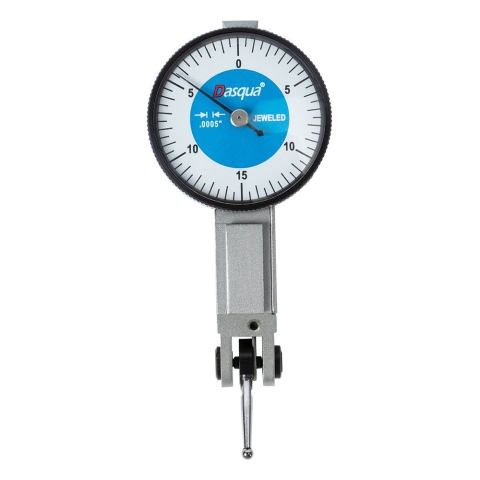

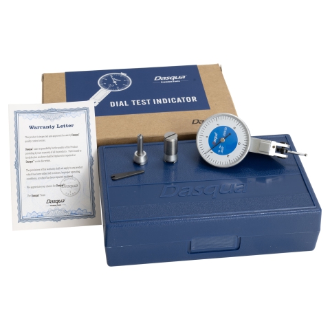

  • Dial test indicator with 0.0005" graduations
  • Range is 0 - 0.030" in either direction
  • Reading 0-15-0
  • Includes 5/32" and 3/8" diameter posts, dovetails on the back and end, and a 0.078" diameter point
  • 7 Jewel movement, Comes in a fitted case
Part Number: 6553
Weight: 0.40 lb
Price: $49.95

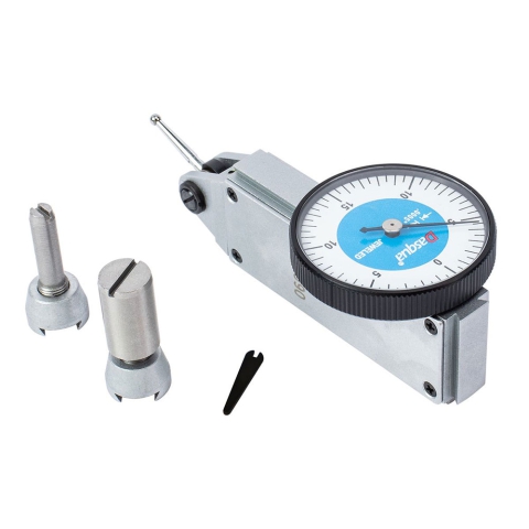

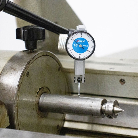

Dasqua 0-.03" White Large Face 0-15-0 Dial Test Indicator. This Test dial indicator Delivers accurate measurements with a graduation of 0.0005" for precise adjustments. The large, white-edged dial provides easy-to-read measurements. It has a range of 0-0.030" in either direction and reading 0-15-0. It includes 5/32" and 3/8" diameter posts, dovetails on the back and end, and a 0.078" diameter point. It comes in a fitted case.

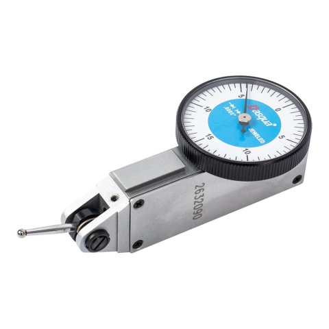

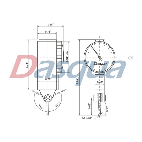

• Dial face is 1-1/2" (37mm) diameter.
• Contact point is 0.078" (2mm).

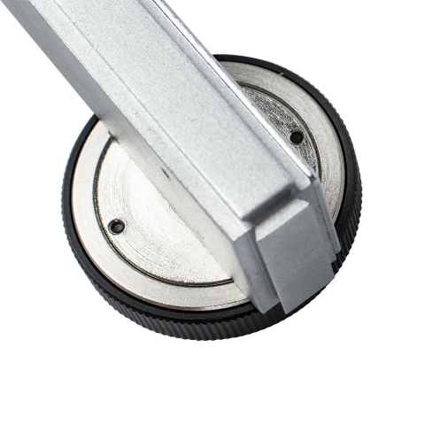

• Dovetail mount on top, back & front.
• Includes 5/32" and 3/8" stems for various applications.
• Length of stylus is 0.053" (13mm).

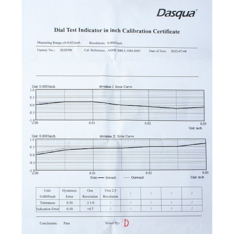

The Dasqua Dial Test Indicator is engineered for precision machinists demanding the highest standards, built with a focus on durability and accuracy. 7-Jeweled movements. A hard frame body and shock-proof gearing with smooth movement to ensure long-lasting performance in demanding environments. Satin chrome finish. Automatic reversing. Backed by a traceable QC system and a two-year warranty for peace of mind. Supplied in a fitted case with warranty letter and calibration certificate.
