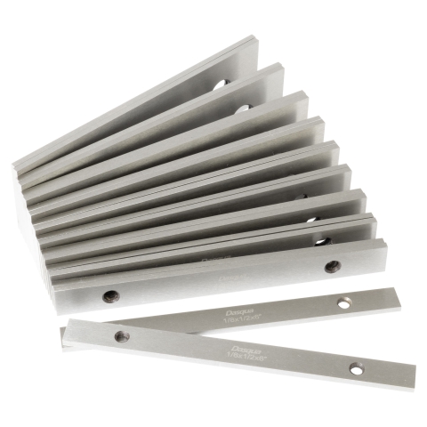

Thin Parallels, 6" Long, 10 Pairs, Premium, Dasqua
- Set of ten pairs of thin parallels in a aluminum case

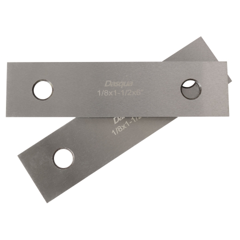

- Parallels are 1/8" thick and 6" long
- Heights are 1/2", 5/8", 3/4", 7/8", 1", 1-1/8", 1-1/4", 1-3/8", 1-1/2", and 1-5/8"
- Made of premium alloy steel, hardened, stress-relieved, precision ground, in pairs
- Highly perpendicular, parallel, and dimensionally accurate
• Heights are 1/2", 5/8", 3/4", 7/8", 1", 1-1/8", 1-1/4", 1-3/8", 1-1/2", and 1-5/8"
• Parallel within 0.0002" on the top and bottom. The pairs are matched in height within 0.0004"
• Height and thickness accuracy is ±0.0004".
• Superior surface finish is Ra0.4um/16uin with a hardness of HRC56-61 which provides a long service life.
• Made of high grade alloy steel hardened to 52 to 58 Rc

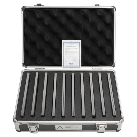

Matched pairs are marked with sizes. These parallels are convenient to use and maintain. Easy to use in drilling, milling and assembly work by providing a reliable and accurate position for the workpiece. Provided in a fitted aluminum case.
