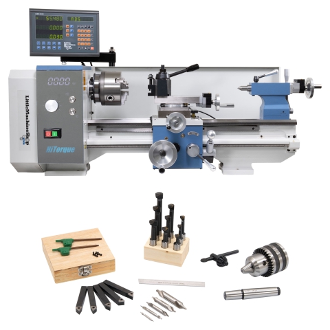

HiTorque Deluxe Bench Lathe, Tooling Package, and stand cabinet. This package includes the #7650 HiTorque Deluxe Bench Lathe and the #3164 Lathe Tooling Package.
The deluxe lathe includes:
• Digital readouts (DRO) on the compound rest, cross slide, carriage, and tailstock
• AXA quick change tool post set with five tool holders
• anodized aluminum hand wheels and aluminum knobs and levers
• Heavy duty splash guard
Standard Bench lathe features include:
• 1000 Watt brushless spindle drive motor for tremendous low-end torque.
• Variable speed from 100 rpm to 2000 rpm continuously in both directions
• NEW LED control panel allows you to stop and then restart the lathe at a pre-selected speed.
• A power cross feed
• Cross feed and compound rest dials are graduated in 0.001" and advance 0.050" per turn.
• A reversible 2 mm pitch lead screw.
• All the gears on this lathe are metal.
The 3164 tooling package comes equipped with a 2MT arbor for the tailstock, a boring bar set, center drills, cut-off blade, 1/2" drill chuck and a set of turning tools with indexable inserts.
Features for the model 7650 deluxe lathe
  • NEW larger spindle through hole - 1.1" (28 mm) accepts 1" stock.
  • NEW greater swing from 8.5" to 9"
  • NEW easy-to-read LED display with built in speed readout
  • NEW factory installed hard-wired DRO on cross slide and carriage
  • DRCD digital readout on compound and tailstock
  • All DROs read equally accurately in inches and mm.
  • 1000 Watt output spindle motor with spindle speed display
  • Genuine NSK bearings
  • Metal gears
  • Induction hardened ways
  • Power longitudinal feed
  • Power cross feed
  • E-stop safety power switch
  • Spindle on-off button
  • Forward/reverse button for spindle and lead screw direction
  • Reversible lead screw allows for right- and left-hand threading
  • Extended threading capability - inch and metric threads
  • Zero-resettable dials graduated at 0.001" and advancing 0.050" per turn
  • Cam-lock tailstock
  • 5" (125 mm) 3-jaw self centering lathe chuck
Swing Over Bed 9.1" (230 mm)
Distance Between Centers 18.1" (460 mm)
Cross Slide Travel 4.7" (120 mm)
Swing Over Cross Slide 4.3" (110 mm)
Spindle Through Hole 1.1" (28 mm)
Spindle Taper #4 Morse taper
Tailstock Taper #2 Morse taper
Range of Threads 6-80 TPI; 0.25-4.0 mm
Spindle Motor Output 1.34 hp (1000 Watts)
Spindle Speed 100 - 2000 RPM
Power Requirements 120 V 60 Hz 15 Amps
Machine Weight 264 lbs (120 kg)
Crated Weight 326 lbs (148 kg)
Overall Dimensions (W x D x H) 36" x 25" x 18" (910 mm x 630 mm x 450 mm)
Crate Dimensions (W x D x H) 42" x 31" x 24" (1060 mm x 780 mm x 600 mm)
