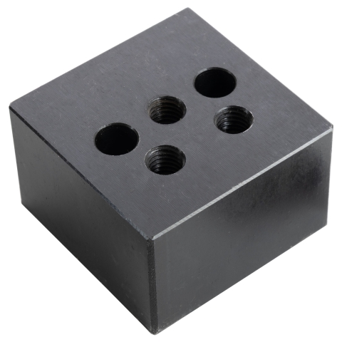

  • Quick change tool post plinth block
  • Adds rigidity to the tool post mounting
  • Designed by, and custom made for LittleMachineShop.com
  • Fits mini lathes with QCTP - replaces compound rest
  • Designed for HiTorque and SIEG C2/SC2 and C3 mini lathes
Part Number: 6783
Weight: 2.21 lb
Price: $24.95

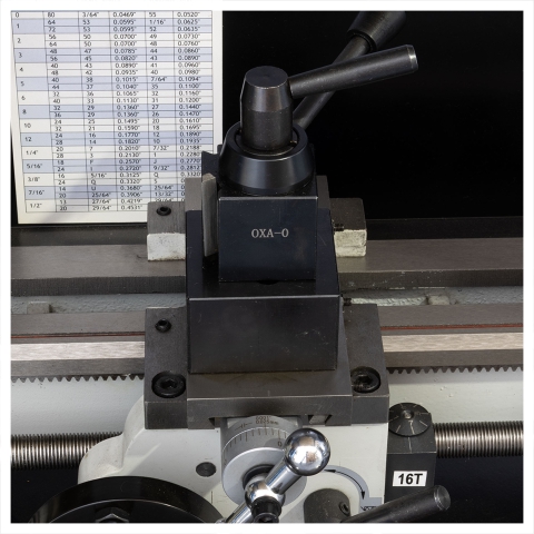

This steel mini lathe plinth block will add rigidity to our tool post mounting. It replaces the compound rest and you mount a standard OXA quick change tool post (QCTP) directly to it!
The plinth block must be used with a quick-change tool post. It will not work with the standard 4-way tool post. This is not as tall as the compound rest so that tool holders are in the middle of the adjustment range on quick change tool posts. (2) M6x25 Socket Head Cap Screws are included.

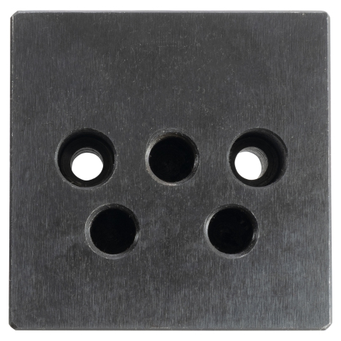

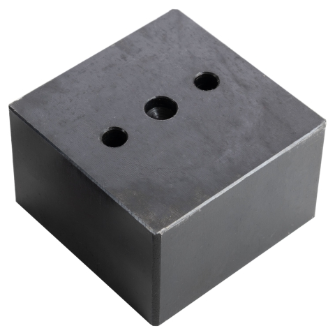

- Mount with the two threaded holes toward the chuck.
- Use the inside threaded hole for small work.
- Use the outside threaded hole for large work.
- Use the center threaded hole for full support when the tool post is at an odd angle.
The mini lathe plinth block is designed by, and manufactured exclusively for LittleMachineShop.com. It will fit HiTorque mini lathes as well as SIEG C2/SC2 and C3 mini lathes including popular models sold by Harbor Freight, WEN, Micro-Mark, Grizzly and others.
