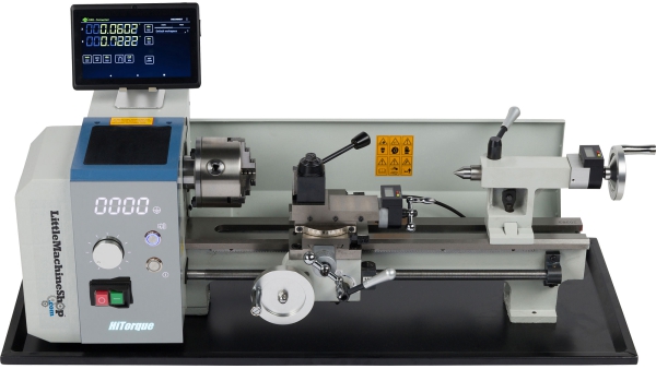

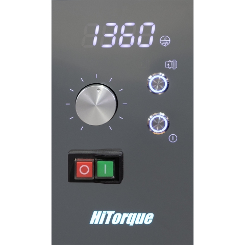

Most noticeable is the LED mirror display which clearly and elegantly organizes the key controls for the lathe. All controls are Illuminated, and it includes a start/stop button, a spindle direction button and emergency power (E-stop) switch. A variable speed control knob allows accurate control of spindle speeds, while an integrated spindle speed display clearly displays the speed.
The 7450 lathe also comes equipped with a 2-axis tablet display DRO connected via Bluetooth to magnetic scales on the longitudinal and cross feeds. It also has 2 digital readouts on the compound rest and tailstock. The DRO system measures in increments 0.0002" and comes factory installed on the lathe.
A 500-Watt brushless spindle drive motor and belt drive provides tremendous power and low-end torque. There are NO gears to shift, so no gears to break. The drive allows for spindle speeds from 100 to 2500 RPM continuously in both directions. NSK brand Japanese-quality spindle bearings ensure smooth and quiet operation.
Standard on the lathe is an all steel, wedge-type quick change tool post which accepts turning tools up to 1/2" shank. Five toolholders are also included for the most common tools and tasks. The lathe also comes with a 4" Sanou lathe chuck, a Morse taper #2 dead center for the tailstock, and an 11-gear change gear set that includes a 21-tooth gear for accurate metric threading. For more details, see the Contents tab.
Real top and bottom half-nuts with a 16 TPI lead screw and a factory-installed threading dial provide extended threading capability. You can create every American Standard Unified class 2A inch screw thread from 4 to 80 threads per inch, and you can create every American Standard Metric class 6h thread from 0.3 to 8 mm pitch with the extra 21 tooth change gear that is included.
The 7x16 lathe includes attractive aluminum hand wheels and chrome levers. A backsplash guard and deluxe chip tray with rubber feet give a broader and more secure stance.

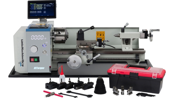

The HiTorque 7x16 Deluxe Mini Lathe, Mirror Display comes with the following:
- Mini Lathe Users Guide written by Chris Wood
- 4" (100 mm) 3-jaw self centering lathe chuck with two sets of jaws and a chuck wrench
- Quick change tool post with five tool holders
- A Morse taper #2 dead center for the tailstock
- An 11-gear change gear set that includes a 21 tooth gear for accurate metric threading
- Two open end wrenches
- Four hex (Allen) wrenches
- A plastic oil can
- Convenient tool box to hold accessories
