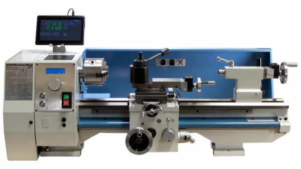

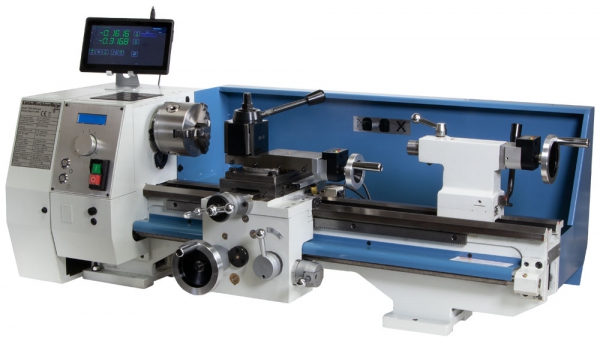

The LittleMachineShop.com HiTorque 8.5x20 Deluxe Bench Lathe is the best in its class. No other lathe this size offers power cross feed. The updated control panel allows you to stop and then restart the lathe at a pre-selected speed.

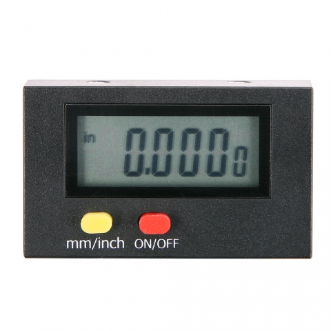

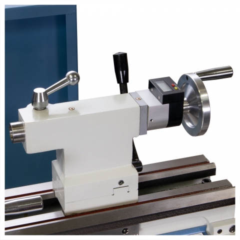

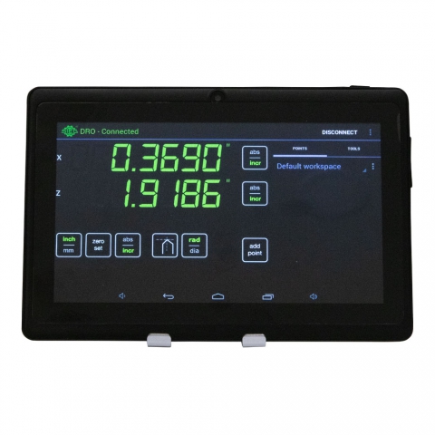

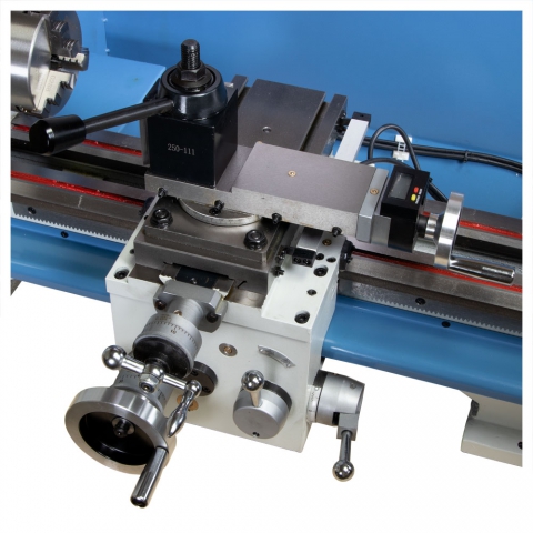

The Deluxe model includes digital readouts (DRO) on the compound rest, cross slide, carriage, and tailstock (cross slide and carriage DROs feed data via magnetic scales to a Bluetooth equipped tablet display). All DROs read equally accurately in inches and mm.

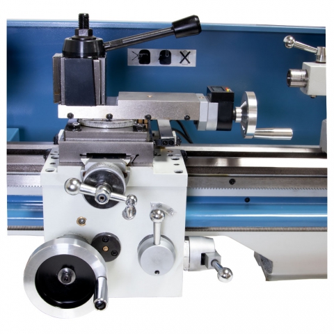

The Deluxe model also includes an AXA quick change tool post set with five tool holders; anodized aluminum hand wheels with black anodizing in the centers; chrome knobs and levers; and a heavy duty splash guard that covers the full bed length. In addition, the compound rest is modified to better accommodate the quick change tool post.

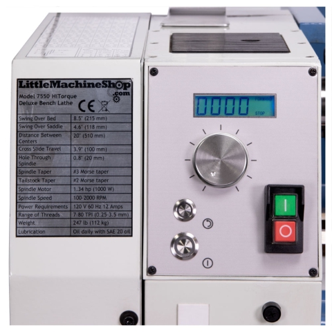

The 1000 Watt brushless spindle drive motor provides tremendous low-end torque. And you can vary the speed from 100 rpm to 2000 rpm continuously in both directions. There are no gears to shift. The updated control panel allows you to stop and then restart the lathe at a pre-selected speed.

Here's Using the Bluetooth DRO Display.
For more information on the Bluetooth DRO, visit the Bluetooth DRO Package page and the Android Tablet page.

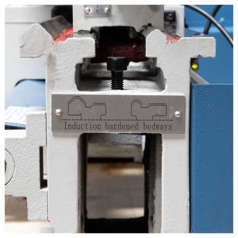

  • Induction hardened ways

HiTorque 8.5x20 Deluxe Bench Lathe- alternate view HiTorque 8.5x20 Deluxe Bench Lathe
HiTorque 8.5x20 Deluxe Bench Lathe - AXA QCTP and DRO AXA quick change tool post, DRO and modified compound rest on HiTorque 8.5x20 Deluxe Bench Lathe
HiTorque 8.5x20 Deluxe Bench Lathe - AXA Tool Post Mounted AXA quick change tool post mounted on modified compound rest on Deluxe HiTorque 8.5x20 Bench Lathe

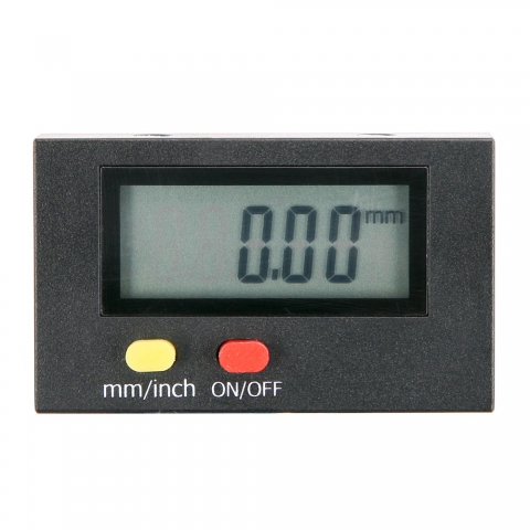

HiTorque 8.5x20 Deluxe Bench Lathe - Tailstock with DRO Tailstock digital dial on the Deluxe HiTorque 8.5x20 Bench Lathe
HiTorque 8.5x20 Deluxe Bench Lathe -control panel - forward Control panel - forward
HiTorque 8.5x20 Deluxe Bench Lathe -control panel - reverse Control panel - reverse
HiTorque 8.5x20 Deluxe Bench Lathe - DRO Bluetooth Display Bluetooth DRO display

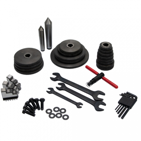

HiTorque 8.5x20 Deluxe Bench Lathe - change gears Change gears
HiTorque 8.5x20 Deluxe Bench Lathe- Induction hardened bedways Induction hardened bedways

"Readout Tailstock and compound DRO display
"Readout Tailstock and compound DRO display in millimeters
"Readout Tailstock and compound DRO display in inches
The Deluxe Bench Lathe comes with the following:
  • 4" (100 mm) 3-jaw self centering lathe chuck with two sets of jaws and a chuck wrench
  • AXA Quick change tool post set
  • A #3 Morse taper dead center for the headstock
  • A #2 Morse taper dead center for the tailstock
  • Change gear set
  • Three open end wrenches
  • Five hex (Allen) wrenches
  • Android tablet for the DRO
