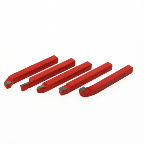

Tool Bits, 5/16" Brazed Carbide, Set of 5
  • 5 piece cutting tool set
  • 5/16" (8mm) shanks
  • Carbide cutting tips
  • Variety of tips for roughing, straight and facing cuts and parting-off
  • Ideal for mini lathes
Part Number: 2412  (Discontinued)
Weight: 0.45 lb
Price: $29.95
This set includes five different brazed carbide turning tools. The shanks are 5/16" (8mm) which is the right size for the mini lathe.
This set includes one each of the following tool bits:
DIN 4971R (ISO1) Straight cutter for rough turning
DIN 4975 (ISO10) Pointed tip for straight turning
DIN 4980R (ISO6) Right angle cutter - offset side cutter for facing
DIN 4980L (ISO6) Left angle cutter - offset side cutter for facing
DIN 4981R (ISO7) Parting-off cutter
