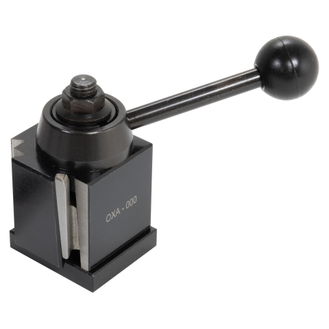

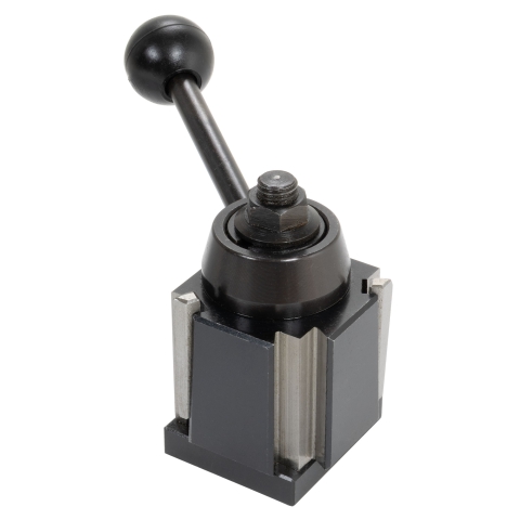

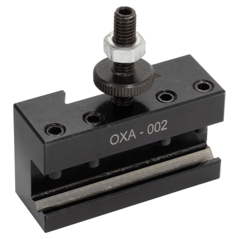

Wedge type 0XA quick change tool post set.
This quick change tool post set is designed for lathes with up to 8" swing.
It is the perfect size for mini lathes. The tool holders have been designed specifically to work on the mini lathes and other lathes that have limited distance from the top of the compound to the center of the lathe. This tool post mounts with an M10 stud, which is included.
This quick change tool post requires 5/8" from the top of the compound rest to the center of the lathe.
All working parts are hardened and ground steel. It is completely sealed for maintenance-free operation.
This tool post mounts with an M10 stud.

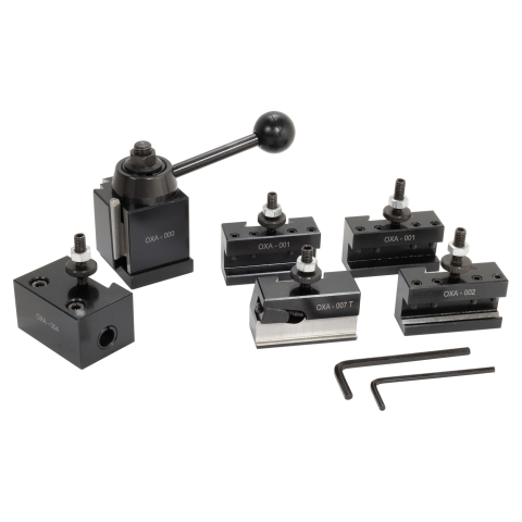

This set includes the tool post and the following tool holders:

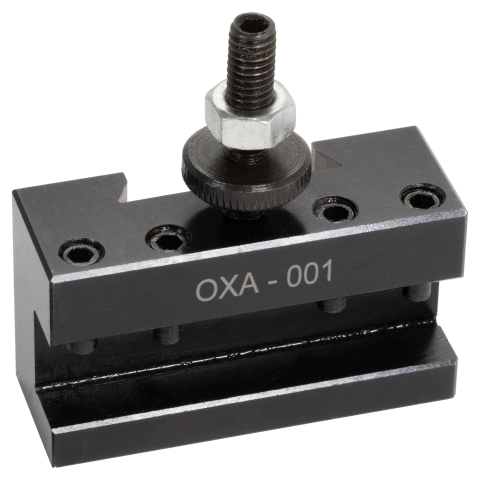

2 - #1 Turning & Facing
1 - #2 Boring, Turning & Facing

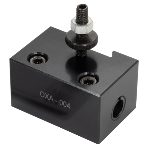

1 - #4 Heavy Duty Boring will hold both 3/8 and 1/2 boring bars

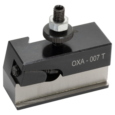

1 - #7 Universal Parting Blade (for 1/2" cut-off blade - horizontal)
