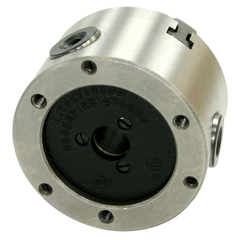

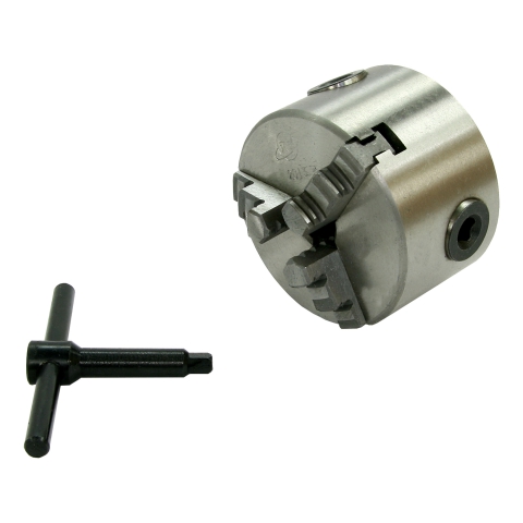

  • Self-centering 3-Jaw lathe chuck
  • 3" (80 mm) diameter
  • Includes chuck key, inside and outside jaws
  • Plain back mounting
  • High quality steel, hardened and ground
Part Number: 1187
Weight: 4.16 lb
Price: $89.95
This 3 inch 3-Jaw self-centering lathe chuck is the one that comes on the mini lathe. It includes a chuck key and inside and outside jaws.
This three jaw chuck has a 0.63" (16 mm) through hole. It holds work up to 2.48" (63 mm) in diameter.
The radial runout of a test bar held in this chuck, when the chuck is mounted true, is 0.003" maximum.
This chuck is a direct replacement for the standard chuck on the mini lathe. The chuck fits directly on the mini lathe's spindle with no modifications or mounting plate required.
This chuck will fit many other lathes when mounted on a backplate chuck adapter. See the list of adapters below.
