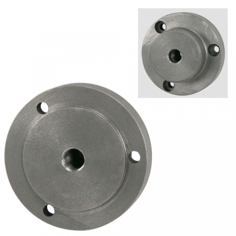

  • Cast iron lathe chuck backplate adapter fits lathes with 1/2"-20 spindle nose thread
  • Adapter is 3" (80 mm) in diameter and has three chuck mounting holes for a 3-jaw chuck
  • For 3" 3-jaw chucks
  • Includes instructions for final turning of the registration diameter to ensure concentricity
Part Number: 2022
Weight: 1.93 lb
Price: $34.95
This adapter is for a 3" 3-Jaw chuck such as LittleMachineShop.com PN 1187.
*NOTE* These adapters require machining on the lathe on which they will be used.
Instructions are included for final turning of the registration diameter on your lathe to ensure perfect concentricity.

These adapters must be machined on your lathe to fit the chuck so that it is concentric on the lathe. In most cases you have to drill the chuck mounting holes also.
We provide complete instructions for mounting the adapter. Our transfer screw sets are the perfect tool for marking the chuck mounting holes on a lathe chuck adapter.
