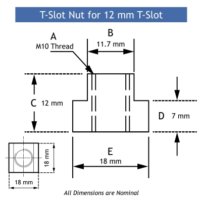

These 12 mm T-slot nuts are threaded M8.
These are the T-slot nuts that come with the mini mill.
They are heat treated and have a black oxide finish.
The stated dimension of the T-slot nut is the width at the top of the T-slot.
Measure the width at the top of the T-slot as shown in the photo below. This is the dimension given for T-slot nuts and clamping kits. For example, if you measure 0.468 at the top of the T-slot, you should get a 7/16” (0.438”) T-slot nut or clamping kit.

Nominal Sizes for 12 mm T-Slot Nut
12 mm t slot nut
