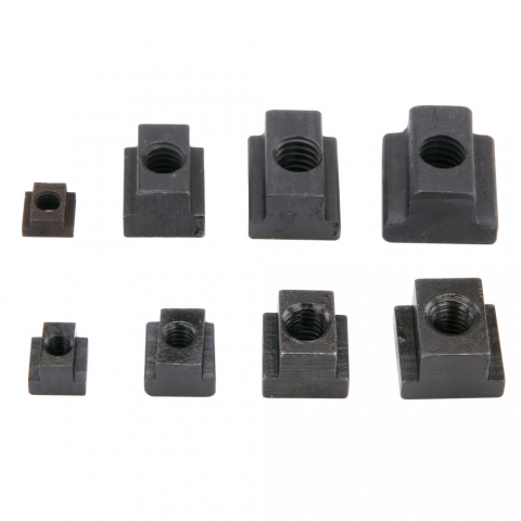

T-Slot Nuts Individual Sizes
- Black oxide finish
- Heat treated 1040 steel
- Case hardened
We carry a wide range of T-Slot nuts in both inch and metric measurements.
They are heat treated and have a black oxide finish.
The stated dimension of the T-slot nut is the width at the top of the T-slot.
