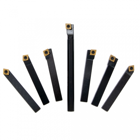

- 7 piece indexable turning and boring set
- 8 mm tool shank
- CCMT21.51 inserts included
- Six turning tools, one boring bar
- Carrying case and T8 wrench included

Turning and boring set with seven pieces. Each tool has an 8 mm tool shank and uses a CCMT21.51 ANSI (CCMT060204 ISO) indexable insert. Additional inserts are available with our part number 1781.
CCMT diamond inserts have four cutting edges.
The turning tools have square shanks while the boring bar has a hexagon shank. (See specifications tab for dimensions.)
See contents tab for what is included in this set.
Set comes in a carrying case and a T8 wrench.

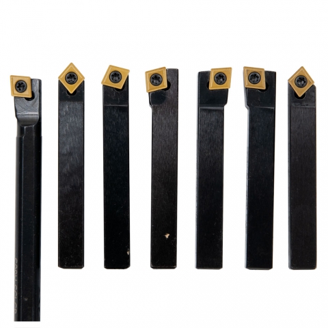

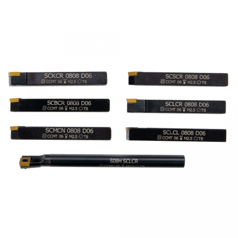

- Turning & Boring Tools, 8mm Indexable, Diamond Inserts Kit Content
- 1 x SCLCL 0808 D06 - Offset shank with -5° end or side cutting, left hand - turning & facing at 90° with 95° approach
- 1 x SCLCR 0808 D06 - Offset shank with -5° end or side cutting angle, right hand - turning & facing at 90° with 95° approach
- 1 x SCKCR 0808 D06 - Offset shank with 15° end cutting edge angle, right hand - through facing with 75° approach
- 1 x SCBCR 0808 D06 - Straight shank with 15° side cutting angle, right hand - turning with 75° approach
- 1 x SCMCN 0808 D06 - Straight shank with 50° side cutting edge angle, neutral - 50° chamfer on both LH & RH side
- 1 x SCSCR 0808 D06 - Offset shank with 45° side cutting edge angle, right hand - 45° chamfer on RH side & 55° on LH side.
- 1 x S08H SCLCR Boring Bar - 4" length, offset shankd with -5° end or side cutting edge angle, right hand
- * All tools use CCMT06 diamond (7° relief) inserts, a M2.5 screw and a T8 Wrench.
