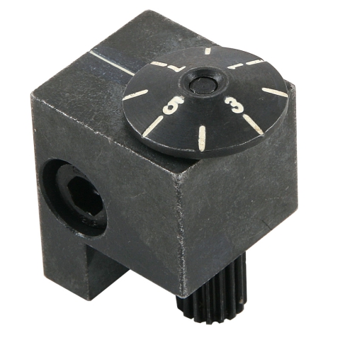

This kit includes all the parts needed to add a thread dial indicator for cutting inch threads to a mini lathe.
This dial assembly DOES NOT help you to cut inch threads on a metric lathe with a metric lead screw.
The threading dial tells you when to engage the half-nuts during threading. It turns when the half nuts are NOT engaged. IT DOES NOT TURN WHEN THE HALF NUTS ARE ENGAGED.
To cut true metric threads on a lathe with an Imperial (inch) lead screw (and vise versa) you can't just change the threading dial. You need our Metric Threading Kit which changes the leadscrew, half nuts and the threading dial.
There is no threading dial available for metric threading.
