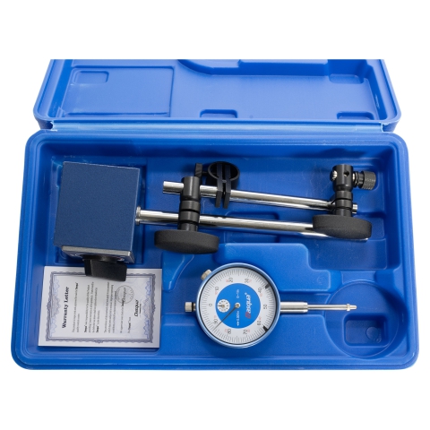

Dial Indicator and Magnetic Base, Dasqua
  • 0-1" Dial indicator
  • Made in accordance with DIN878.
  • Magnetic base with fine adjustment
  • On/off switch makes it easy to position
  • V-groove base allows you to mount it on cylindrical surfaces
Part Number: 1593
Weight: 4.60 lb
Price: $54.95

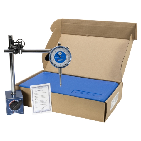

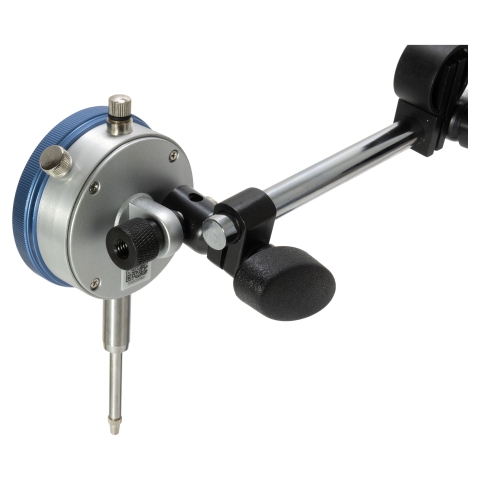

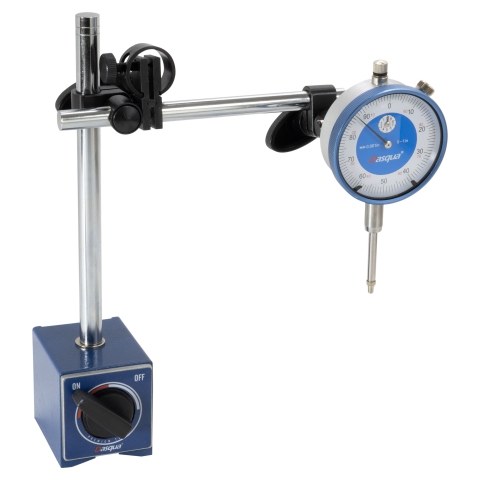

Dasqua 2 Piece Magnetic Base and 1" Indicator Set. This 1" stroke magnetic dial indicator features large, easy to read numbers and crisp graduations.

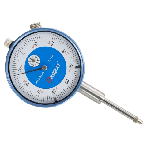

The indicator is a 0-1" lug back large measuring range dial indicator. Each revolution is 0.100". It has a satin chrome-plated steel case with a diameter of 58mm and a shank diameter of 8mm.
• accuracy is 0.002″
• hysteresis is 0.00033″
• scale divisions are 0.001".
• This indicator is strictly made in accordance with DIN878.

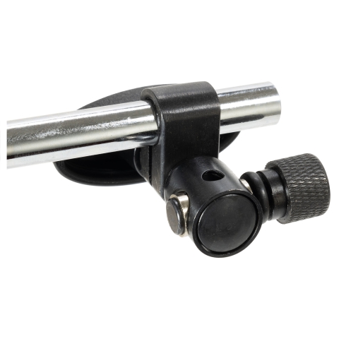

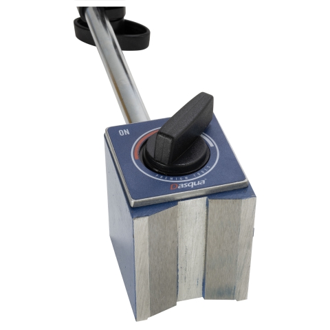

The magnetic base has 132 lbs of magnetic force with fine adjustment. It is a v-grooved base for ease of mount on cylindrical parts and has chrome plated rods. The mag base has both horizontal or vertical positioning capabilities. Smooth and easy on/off switch.
• Base is 60mm (2.36") x 50mm (1.97") x 55mm ( 2.17").
• Main rod is 12mm (.47") diameter x 176mm (6.93").
• 2nd rod is 10mm diameter (.39")x 150mm (5.91").
• Clamp hole diameters are 6mm (.24"), 8mm (.31") & 3/8".

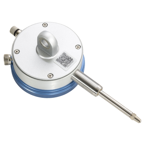

Range 0" - 1" (0 mm - 25 mm)
Resolution 0.001" (0.03 mm)
A.G.D. Group 2
Face Diameter 2.25" (57.1 mm)
Shank Size 0.375" (9.52 mm)
Thread Tip #4-48
Dial Reading 0-100-0
Revolution 0.100" (2.54 mm)
Dial Face Continuous Dual Reading
