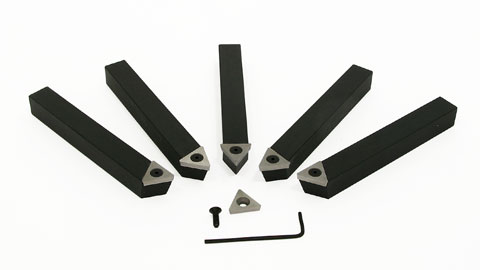

  • 5 metal turning tools 1/2" shank, 4" overall length
  • Tool styles are AR, AL, BR, BL, & E
  • 6 turning inserts, TPMB-322
  • 6 screws
  • 1 - 1/16" Allen wrench
Part Number: 1620
Weight: 1.76 lb
Price: $214.95
PayPal Credit
This Arthur R. Warner Co. precision tool holder kit uses HSS, combining the advantages of high speed steel cutting tools with the convenience of indexable tooling.
The kit contains the following:
5 1/2" indexable turning tool bars and shank 4 inches overall length
6 Turning Inserts: T-15 High Speed Steel TPMB-322 (TD6P)
6 4-40FH screws and one 1/16" hex wrench.
The TPMB322 insert:
Relief : 11 degree
IC: 0.375 inch
Thickness: .125 inch
Hole: 0.150 inch Top opening: 0.250 inch
Radius: 0.031 inch
Each tool holder is a different style. There is one each of the following:
Style AR right hand tool
Style BR right hand tool with a 15° lead angle
Style E Neutral threading tool with 60° included angle
Style BL left hand tool with a 15° lead angle
Style AL left hand tool
