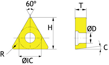

Insert, TPMB-321 HSS
- T-15 high speed steel
- 60° triangle, 11° relief
- 70°-90° single countersink, no chip breaker
- 0.0156" (1/64") corner radius
- ANSI: TPMB321, ISO: TPMB160304 HSS
TPMB-321 insert made from T-15 high speed steel, combine the advantages of high speed steel cutting tools with the convenience of indexable tooling.
Insert is a 60° triangle with a 11° relief. The center hole is a 70°-90° single countersink, and there is no chip breaker.
It has an inscribed circle (IC) of 0.375" (3/8"), a thickness of 0.125" (1/8"), and a corner (nose) radius of 0.0156" (1/64").
The insert is designated TPMB321 (ANSI) or TPMB160304 HSS (ISO). For a list of compatible LittleMachineShop.com products, see the Compatibility tab.
This high-quality insert is made in America by the Arthur R Warner company.
