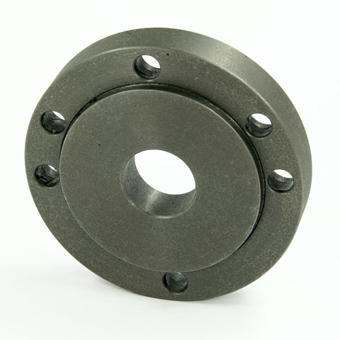

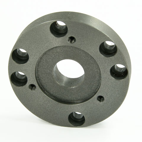

Adapter, 3" Spindle to 4" Lathe Chuck - 72MM Recess
- Compatible with 4" 3- or 4-Jaw Lathe Chucks on Mini Lathes
- Use with Chucks with a 72 mm Registration Recess Diameter
- Cast Iron
- Net Thickness of 0.66"
This adapter lets you mount 4" 3- or 4-jaw lathe chucks on your mini lathe.
Use this adapter with chucks that have a 72 mm registration recess diameter.
The adapter mounts to the 3-hole pattern on the spindle so it works on spindles with only three holes.
This adapter is cast iron and has a net thickness of 0.66". The net thickness is the distance from the rim of the lathe spindle to the back of the chuck.
Chris' Tips| Outside Diameter | Ø 3.9" (100 mm) |
| Center Hole | Ø 1.0" (25 mm) |
| Spindle Side Registration Recess | Ø 2.2" (55 mm) |
| Spindle Side Bold Circle | Ø 2.6" (66 mm) |
| Chuck Side Registration Boss | Ø 2.8" (72 mm) |
| Chuck Side Bolt Circle | Ø 3.3" (84 mm) |
| Chuck Mounting Holes | 3-bolt & 4-bolt patterns |
