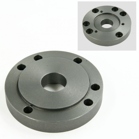

  • Compatible with 4" 3- or 4-Jaw Lathe Chucks on Mini Lathes
  • Use with Chucks with a 72 mm Registration Recess Diameter
  • Cast Iron
  • Net Thickness of 0.66"
Part Number: 1692
Weight: 1.81 lb
Price: $24.95
This adapter lets you mount 4" 3- or 4-jaw lathe chucks on your mini lathe.
Use this adapter with chucks that have a 72 mm registration recess diameter.
The adapter mounts to the 3-hole pattern on the spindle so it works on spindles with only three holes.
This adapter is cast iron and has a net thickness of 0.66". The net thickness is the distance from the rim of the lathe spindle to the back of the chuck.
Don't forget to get a set of studs and nuts to mount this.
Outside Diameter Ø 3.9" (100 mm)
Center Hole Ø 1.0" (25 mm)
Spindle Side Registration Recess Ø 2.2" (55 mm)
Spindle Side Bold Circle Ø 2.6" (66 mm)
Chuck Side Registration Boss Ø 2.8" (72 mm)
Chuck Side Bolt Circle Ø 3.3" (84 mm)
Chuck Mounting Holes 3-bolt & 4-bolt patterns
This product works with lathes with a 80 mm flange chuck mount including:
  •   SIEG C1 6x10 Micro Lathe
  •   SIEG C2 7x12 Mini Lathe
  •   SIEG SC2 7x12 Mini Lathe
  •   SIEG C3 7x14 Mini Lathe
