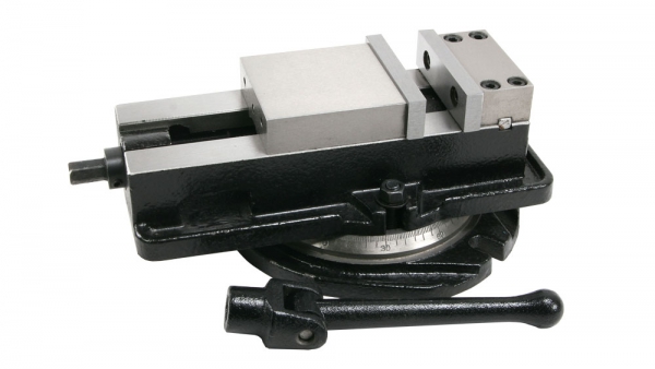

Vise, 3" Precision Milling, Heavy, with Swivel Base
- Precision 3" Kurt-style milling machine vise
- Detachable swivel base features easy to read divisions
- Hardened replaceable jaws
- The top, bottom of vise bed, gib, jaws, swivel base, and all plate mounting surfaces are ground
- 30% Downward Locking Force
3" High quality Kurt-style milling vise with detachable 360° swivel base and easy to read divisions. Top, gib, jaws, bottom of vise bed and all plate mounting surfaces are precision ground. The angle tight positive locking style and wide jaw opening allows for holding a large array of workpieces securely. The hardened and ground jaws are made to American standard dimensions (interchangeable with Kurt) and provide a flat and parallel gripping surface that ensures accurate and consistent clamping. The jaws can be mounted on either end of the fixed and movable jaw providing a wide range of clamping distances.
Overall length is 10.85” and the height is 3.05” without base, and 4.21” with base. Jaws are 3.15” wide, 0.94” deep, open 3”, and are perpendicular to the ways within 0.002” in 4”. The ways are parallel to the base within 0.0006” in 4” without the swivel.
Chris' Tips| Jaw width | 3.15" (80.0 mm) |
| Jaw depth | 0.94" (23.9 mm) |
| Maximum jaw opening | 3.0" (76 mm) |
| Swivel base | Yes |
| Weight | 22 lbs (10 kg) |
| Height with base | 3.76" (95.5 mm) |
| Height w/o base | 2.73" (69.3 mm) |
| Length | 10.00" (254.0 mm) |
| Width with base | 7.25" (184.1 mm) |
| Width w/o base | 4.80" (121.9 mm) |
| Mounting bolt centers | 6.00" (152.4 mm) |
| Mounting bolt centers w/o base | 4.00" (101.6 mm) |
| Hold-down mechanism | Yes |
| Ways parallel to bottom of vise within | 0.0006" in 4" (0.015 mm in 100 mm) |
| Ways parallel to bottom of swivel base within | 0.0008" in 4" (0.020 mm in 100 mm) |
| Jaws perpendicular to ways within | 0.002" in 4" (0.05 mm in 100 mm) |
