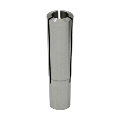

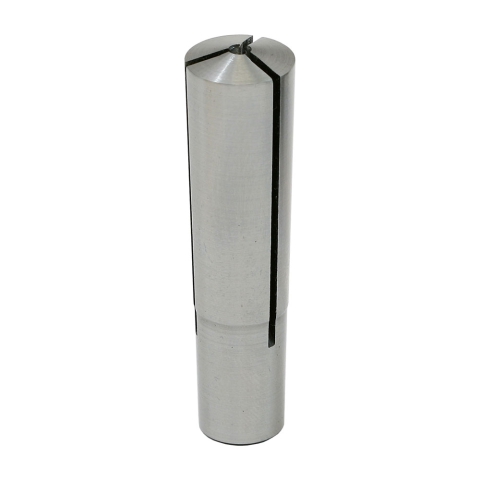

Collet, 2MT, 7/16"
Collet, 2MT, 7/16"
  • 7/16" #2 Morse taper collet
  • Overall length is 2.67" (68 mm)
Part Number: 1750
Weight: 0.14 lb
Price: $13.95
7/16" 2 Morse taper collet to fit spindles with a Morse taper. This collet is made from high-grade tool steel and is precision ground and hardened.
The drawbar thread is 3/8"-16 and the overall length is 2.67" (68 mm).
You might need to a make or purchase a drawbar to work with these tools.
Hole Diameter 0.438" (11.11 mm)
Drawbar End 3/8"~16
