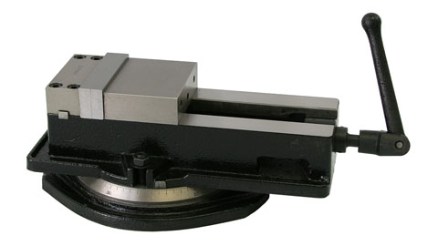

  • Precision 4" Kurt-style milling machine vise with swivel base.
  • Ground surfaces.
  • Jaws hardened and ground.
  • Fixed jaw is bolted for enhanced rigidity.
  • Detachable swivel base features easy to read divisions.
Part Number: 1755
Weight: 35.1 lb
Price: $179.95
PayPal Credit
4" High quality Kurt-style milling vise. Top, gib, jaws, bottom of vise bed and all plate mounting surfaces are precision ground. The fixed jaw is bolted from the top for enhanced rigidity. The angle tight positive locking style and wide jaw opening allows for holding a large array of workpieces securely. The hardened and ground jaws are made to American standard dimensions (interchangeable with Kurt) and provide a flat and parallel gripping surface that ensures accurate and consistent clamping. The jaws can be mounted on either end of the fixed and movable jaw providing a wide range of clamping distances.
The jaws are 4" wide, 1.27" deep and open 5.4".
With the base, the vise is 9.7" wide, 13.4" long, and 4.75" high.
Without the swivel base, the ways of the precision milling vise are parallel to the base of the vise within 0.0006" in 4". The jaws are perpendicular to the ways within 0.002" in 4". With the swivel base installed, the ways of the vise are parallel to the base of the vise within 0.0008" in 4".
THIS VISE IS TOO BIG FOR A MINI MILL. Don't even think about purchasing this vise for a mill smaller than a Mill with a 20" x 6" table. We recommend a 3" vise for the mini mill.
Take a look at our vise comparison page before you choose a vise.
Jaw Width 4" (102 mm)
Jaw Depth 1.18" (30.0 mm)
Maximum Jaw Opening 5" (137 mm)
Swivel Base Yes
Weight 35 lbs (16 kg)
Height with Out Base 3.46" (87.9 mm)
Length 13.4" (340 mm)
Hold-Down Mechanism Yes
Ways Parallel to Bottom of Vise Within 0.0006" in 4" (0.015 mm in 100 mm)
Ways Parallel to Bottom of Swivel Base Within 0.0008" in 4" (0.020 mm in 100 mm)
Jaws Perpendicular to Ways Within 0.002" in 4" (0.05 mm in 100 mm)
