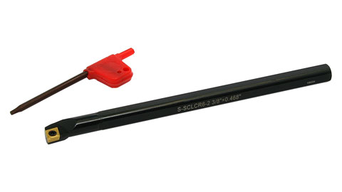

  • Profiling bars for semi-finishing and finishing operations
  • Designed for CCMT 80° inserts (one insert included)
  • 7° Relief angle
  • Negative 5° Lead angle for boring
  • 3° Side & end cutting edge angle
Part Number: 1779
Weight: 0.21 lb
Price: $39.95
This 3/8" diameter indexable boring bar uses CCMT inserts.
Minimum bore diameter is 0.50"
Use CCMT 21.51 or CCMT 21.52 inserts with this boring bar set.
Overall Length 6" (152 mm)
Diameter 0.375" (9.52 mm)
Minimum Bore 0.500" (12.70 mm)
CCMT Inserts 80°
Replacement Inserts CCMT-21.51 or CCMT-21.52
Relief Angle
Lead Angle for Boring -5°
Side & End Cutting Edge Angle
Screw M2.5x8
Torx Wrench T-8
This product works with lathes with a 0.375 to 0.5 inch tool bit size including:
