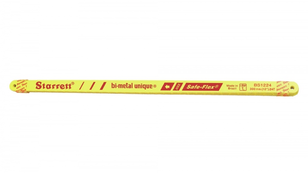

Hacksaw Blade, Bi-Metal, 24 TPI, Starrett
  • Starrett bi-metal unique HSS Safe-Flex hacksaw blade
  • 12" X 1/2" X .025" (300mm X 13mm X 0.65mm)
  • 24 TPI (Teeth per Inch)
  • Starrett catalog number BS1224
  • Sold Individually
Part Number: 1851
Weight: 0.04 lb
Price: $2.26
The Starrett hacksaw blade is 12" long, 1/2" wide and has 24 teeth per inch. The blade is 0.025" thick.
Unique high speed steel Safe-Flex bi-metal hacksaw blades are made with a patented solid-state diffusion process with 170% more HSS weld area and ground teeth for reduced blade fracture, faster cutting and longer life
Get the correct hacksaw blade for the material you are cutting:
Cross Section To Be CutUse PitchP/N
Inchmm
7/32" - 3/4" 6 - 19 mm 14 1849
3/16" - 1/2" 5 - 13 mm 18 1850
1/8" - 7/16" 3 - 11 mm 24 1851
3/32" - 5/16" 2.5 - 8 mm 32 3561
Note that there is a lot of overlap in the cross section column. Use coarser pitches for faster cutting and finer pitches for smoother cutting.
