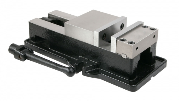

Vise, 4" Precision Milling, Heavy, No Swivel Base
- Precision 4" Kurt-style milling machine vise
- Ground surfaces
- Jaws hardened and ground
- Fixed jaw is bolted for enhanced rigidity
- 30% Downward Locking Force
4" High quality Kurt-style milling vise. Top, gib, jaws, bottom of vise bed and all plate mounting surfaces are precision ground. The fixed jaw is bolted from the top for enhanced rigidity. The angle tight positive locking style and wide jaw opening allows for holding a large array of workpieces securely. The hardened and ground jaws are made to American standard dimensions (interchangeable with Kurt) and provide a flat and parallel gripping surface that ensures accurate and consistent clamping. The jaws can be mounted on either end of the fixed and movable jaw providing a wide range of clamping distances.
The jaws are 4" wide, 1.27" deep and open 5.5".
The ways of the drill press milling vise are parallel to the base of the vise within 0.0006" in 4". The jaws are perpendicular to the ways within 0.002" in 4".
| Jaw Width | 3.94" (100.0 mm) |
| Jaw Depth | 1.26" (32.0 mm) |
| Maximum Jaw Opening | 5.5" (140 mm) |
| Weight | 24.6 lbs (11.2 kg) |
| Height w/o Base | 3.54" (90.0 mm) |
| Length | 12.8" (325 mm) |
| Width w/o Base | 6.3" (160 mm) |
| Mounting Bolt Centers w/o Base | 5.5" (140 mm) |
| Hold-Down Mechanism | Yes |
| Ways Parallel to Bottom of Vise Within | 0.0006" in 4" (0.015 mm in 100 mm) |
| Jaws Perpendicular to Ways Within | 0.001" in 4" (0.03 mm in 100 mm) |
