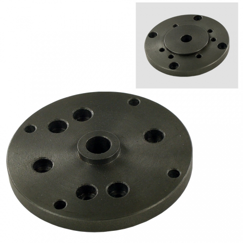

  • For rotary tables with 24 mm registration hole in center
  • This adapter is included with the 1810 rotary table and 2183 rotary table package
  • Use with a 3" 3- or 4-jaw lathe chuck
  • Compatible with rotary table with 2 Morse taper center hole
Part Number: 1888
Weight: 1.44 lb
Price: $34.95
3" Lathe chuck adapter.
This adapter lets you mount a 3" 3- or 4-jaw lathe chuck on a rotary table with a 2 Morse taper center hole. There is an alignment boss that projects into the tapered hole for quick alignment. It is clamped to the rotary table with T-slot nuts that are not included.
You will need to machine the alignment boss to fit your rotary table.
Outside Diameter Ø 3.9" (100 mm)
Center Hole Ø 0.6" (14 mm)
Table Side Registration Boss Ø 0.9" (24 mm)
Table Side Bolt Circle Ø 3.6" (91 mm)
Adapter Mounting Holes 4
Chuck Side Registration Boss Ø 2.2" (55 mm)
Chuck Side Bolt Circle Ø 2.6" (66 mm)
Chuck Mounting Holes 6
