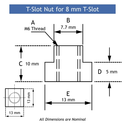

The stated dimension of the clamping kit is the width at the top of the T-slot.
Measure the width at the top of the T-slot as shown in the photo below. This is the dimension given for T-slot nuts and clamping kits. For example, if you measure 0.468 at the top of the T-slot, you should get a 7/16” (0.438”) T-slot nut or clamping kit.

*Indicates t-slot nuts included as part of a clamping kit.
Nominal Sizes for 8 mm T-Slot Nut
8 mm t slot nut
