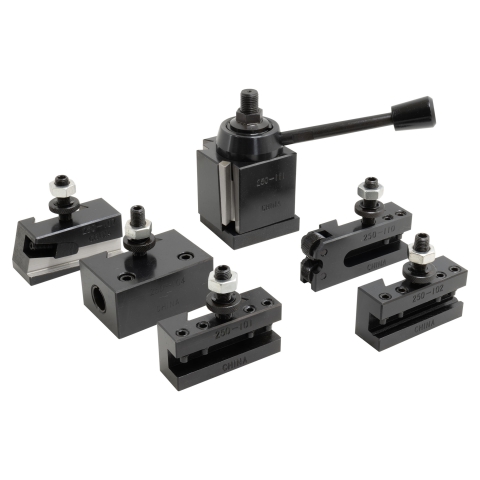

AXA, or series 100, wedge type quick change tool post set is designed for lathes with up to 12" swing.
All working parts are hardened and ground. This lathe tool post set is completely sealed for maintenance-free operation.
This lathe tool post set includes the tool post and the following tool holders:

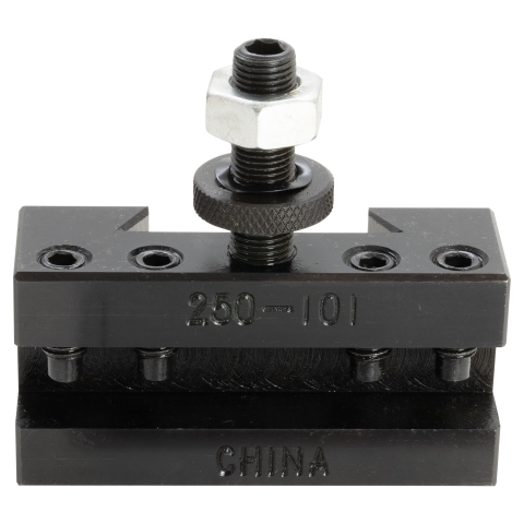

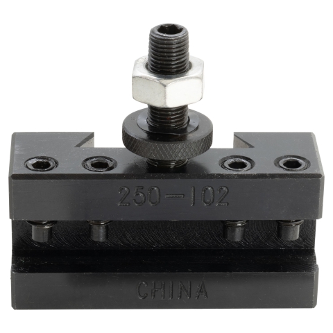

No. 1 - Turning & Facing Tool Holder

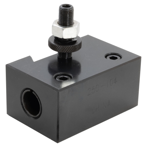

No. 2 - Boring, Turning & Facing Tool Holder
No. 4 - Heavy Duty Boring Tool Holder, will hold 5/8" or 3/4" round shanks.

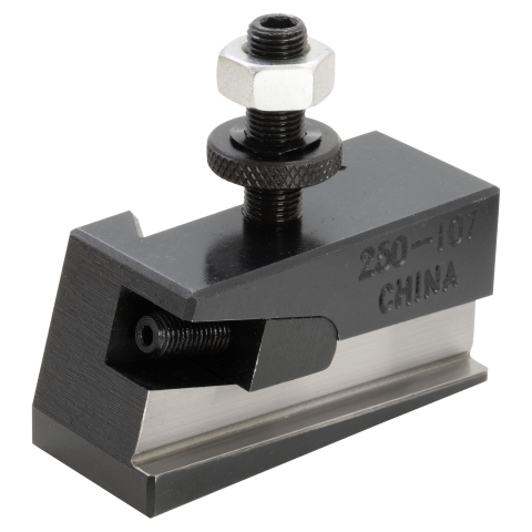

No. 7 - Universal Parting Blade Holder

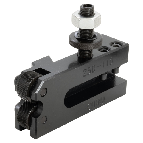

No.10 - Knurling, Facing & Turning.
This set includes a 9/16"-18 threaded stud and a piece of steel from which you can make a T-slot nut to fit your lathe. The tool holders interchange with Aloris, Dorian, and Phase II.

"Quick Change Tool Post Set No. 1 - Turning & Facing Tool Holder

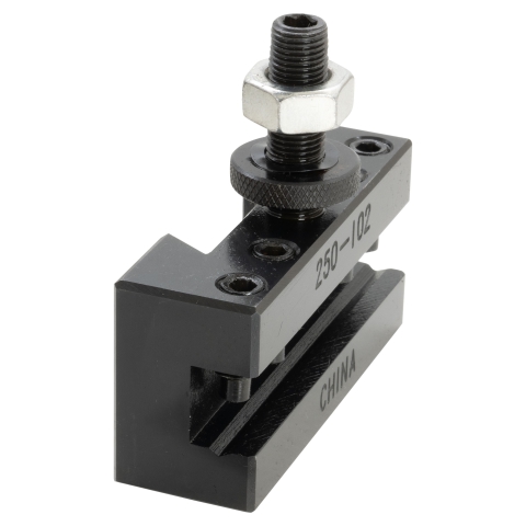

"Quick Change Tool Post Set No. 2 - Boring, Turning & Facing Tool Holder
"Quick Change Tool Post Set No. 2 - Holder, side view

"Quick Change Tool Post Set No. 7 - Universal Parting Blade Holder
"Quick Change Tool Post Set No.10 - Knurler, Facing & Turning

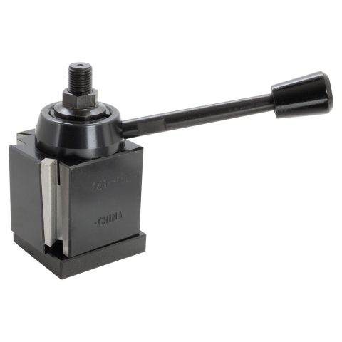

"Quick Change Tool Post Set Tool Post
