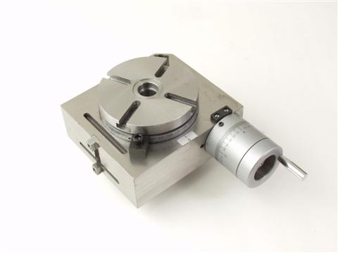

Rotary Table, 6" Precision 2326  (Discontinued)
Part Number: 2326  (Discontinued)
Weight: 40.0 lb
Price: $379.95
This horizontal / vertical rotary table is made of precision machined cast iron and has a 2 Morse taper center hole. The table is graduated with a 360° scale. The rotary table is furnished with lock down clamps.
The table is 3.70" high when horizontal, and the centerline is 3.86" above the table when in the vertical position.
The worm ratio is 72 to 1.
Flatness of clamping surface: 0.0008"
Parallelism of clamping surface to base: 0.0008"
Squareness of clamping surface to angle face: 0.0012"
Squareness of clamping surface to center slot: 0.0012"
Concentricity of center bore: 0.0008" TIP
