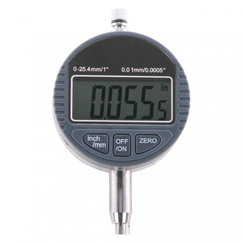

Electronic Digital Indicator, 1"
  • Measurement range is 0-1"
  • Resolution is 0.0005", accuracy is 0.0012"
  • Measures in inches or mm
  • Set to zero at any position
  • Relative and absolute measurement
Part Number: 2521
Weight: 0.53 lb
$64.95 On Sale
Regularly $69.95
This is an AGD Group 2 indicator with a 0.375" diameter shank and a #4-48 thread for tips.
There are three buttons; ON/OFF for power, RESET to zero the display, and R/A to switch between absolute and relative measurement.
Pressing R/A zeros the indicator at any position so you can make comparative readings between two parts. The absolute measurement is not lost, and is displayed by pressing R/A again.

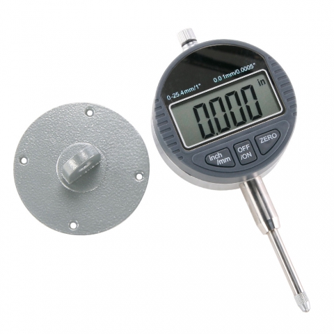

Range 0" - 1" (0 mm - 25 mm)
Resolution 0.0005" (0.013 mm)
A.G.D. Group 2
Face Diameter 2.23" (56.6 mm)
Shank Size 0.375" (9.52 mm)
Thread Tip #4-48
Accuracy 0.001" (0.03 mm)
Type Flat Back
Dial Face Digital in/mm
1 inch Electronic Digital Indicator Indicator Face
