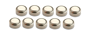

Battery, LR44 Alkaline, Set of 10
This is a card of 10 LR 44 batteries.
These LR44 alkaline batteries fit most electronic digital calipers.
11.6 mm diameter, 5.4 mm thick.
1.50 volts (nominal), 105 mAh.
These batteries interchange with AG13, D357, 357, A76, LR44W, CX44, SR44.
