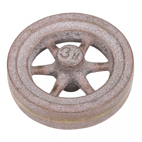

The flywheel casting is oversize so you can finish it to the specified diameter.
Photo shows the flywheel partly machined. This flywheel has a rim width of 0.779", a rim thickness of 0.285", a hub diameter of 0.715", and an overall hub length of 1.212".
