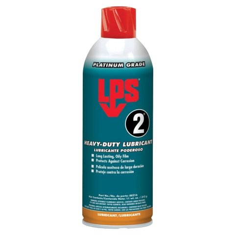

LPS 2 Industrial-Strength LubricantMade in United States
  • Strong multi-purpose lubricant and penetrant
  • Creates light oily protective film that is non-drying
  • Loosens rust and frozen components and is an excellent protection for metal parts
  • Does not contain silicone
  • Safe on paints, plastics, and rubbers
Part Number: 2908
Weight: 0.80 lb
Price: $21.95
The strong, multi-purpose lubricant and penetrant with corrosion protection. Leaves an oily film that is non-drying and light. Reduces wear from friction.

LPS 2 is wet film lubricant i.e. it does not dry but remains a long-lasting oily film. LPS 2 utilizes a proprietary blend of oils and lubricant additives to provide 1+ years of lubrication and protection to industrial equipment and parts. Not only does it lubricate, but LPS 2 is also good at protecting small metal parts from rusting during shipment. LPS 2 is also kind of a hybrid in that it protects metals, provides lubrication and can even act as a penetrant, if needed. Use LPS 2 for any application that demands a light, long-lasting, industrial oily film; think metal parts in storage, cable, pulleys, metal rollers, hand tools, valves, connectors, slides, dies, bits and fasteners. Think LPS 2.

Boiling Point / Range 383°F (195°C) @ 101kPa
Flammability lower 0.6%
Flash Point 174.2°F (79.0°C) Tag Closed Cup (dispensed liquid)
Percent Volatile 92 - 95%
Propellant Carbon Dioxide
Temperature Range -60°F to 350°F
Voc Content 0.4% per US State & Federal Consumer Product Regul
