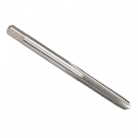

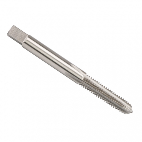

  • M6x1.0 Metric Hand Tap
  • Plug style (3-5 chamfered threads)
  • High speed steel (HSS)
  • Utilize in through or blind hole tapping
  • Metric Coarse Thread
Part Number: 2940
Weight: 0.03 lb
Price: $12.95
Hand taps are the most commonly used general purpose tap. They are recommended for tapping free machining steels, stainless steels, aluminum, zinc, and ductile materials.
Plug taps have 3-5 chamfered threads and are utilized in either through or blind hole tapping.
The High Speed Steel (HSS) construction gives good wear-resistance.
Tap Type Hand Tap
Thread Size M6x1.0
Class of Fit 6H
Thread Limit D5
Number of Flutes 4
Chamfer Plug
Material High Speed Steel
Thread Direction Right Hand
Thread Standard Metric Coarse
Overall Length (Inch) 2.5000" (63.500 mm)
Thread Length (Inch) 1.0000" (25.400 mm)
