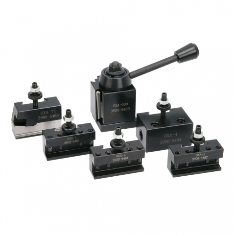

  • Quick change tool post set for lathes with up to 8" swing
  • 0XA, or series 000 size (60% of AXA size)
  • Includes five steel tool holders
  • Horizontal Cut-off tool holder
  • Fits all 7x10 to 7x16 mini lathes
Part Number: 3112
Weight: 4.43 lb
Price: $189.95
PayPal Credit
Wedge type 0XA quick change tool post set. This is the same Premium QCTP set that comes stock on our HiTorque Mini Lathes.
This quick change tool post set is designed for lathes with up to 8" swing.
It is the perfect size for mini lathes. The tool holders have been designed specifically to work on the mini lathes and other lathes that have limited distance from the top of the compound to the center of the lathe. This tool post mounts with an M10 stud, which is included.
This quick change tool post requires 5/8" from the top of the compound rest to the center of the lathe.
All working parts are hardened and ground steel. It is completely sealed for maintenance-free operation.
This tool post mounts with an M10 stud.
This set includes the tool post and the following tool holders:
(Tools hold up to 1/2" square shanks.)
2 - #1 Turning & Facing
1 - #2 Boring, Turning & Facing
1 - #4 Heavy Duty Boring will hold both 3/8 and 1/2 boring bars
1 - #7 Universal Parting Blade (for 1/2" cut-off blade - horizontal)
This QCTP is a bolt-on accessory for the mini lathe.
To mount this QCTP on other small lathes, you may have to make a bushing or re-work the center stud so that you can mount it to a smaller threaded hole
See the comparison chart of the quick change tool post sets we carry.
The 0XA quick change tool post and the associated tool holders were developed by Tormach and LittleMachineShop.com in cooperation.
The 0XA tool post and tool holders were optimized to work with all versions of mini lathes, including 7x10, 7x12, 7x14 and 7x16 mini lathes.
The two 0XA tool posts (3112 and 3048) are the same except for the cut-off tool holder.
The 3112 has a cut-off tool holder that mounts the blade horizontally. Thus it can be used on lathes that have only 5/8” from the top of the compound to the centerline of the lathe, like the 7x mini lathes.
The 3048 has a cut-off tool holder that mounts the blade at a 4 degree angle. It needs ¾” from the top of the compound to the centerline because of the angled cut off blade.

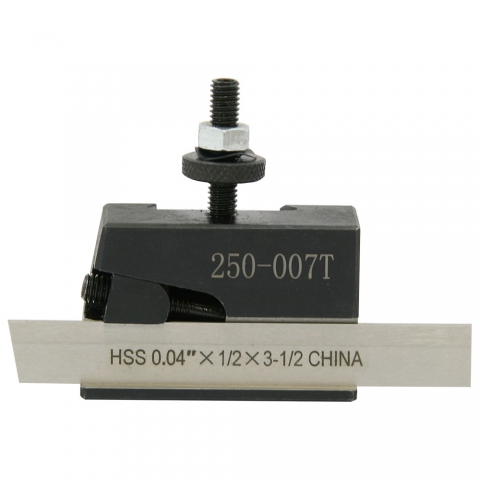

View of Cut-Off Tool Holder, 0XA, with half inch cut-off blade
"QC Cut-Off Tool Holder Universal Parting Blade Tool Holder showing pitch of cut-off blade.
