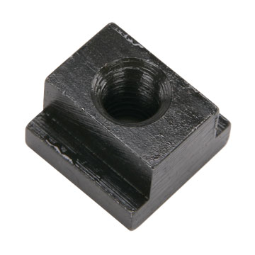

T-Slot Nut, 10 mm
T-Slot Nut, 10 mm
  • Fit 10 mm T-slots
  • Threaded M8
  • Black oxide finish
  • Heat treated 1040 steel, case hardened
  • Fits T-slots measuring 0.38" - 0.45" in width
Part Number: 2991
Weight: 0.04 lb
Price: $4.07
These T-slot nuts fit a 10 mm T-slot and are threaded M8.
They are heat treated and have a black oxide finish.

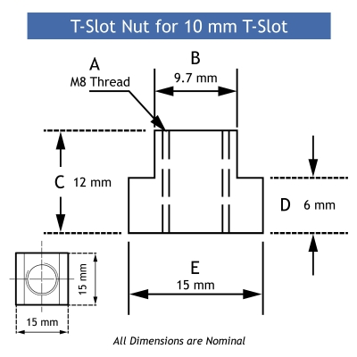

The stated dimension of the T-slot nut is the width at the top of the T-slot.
Measure the width at the top of the T-slot as shown in the photo below. This is the dimension given for T-slot nuts and clamping kits. For example, if you measure 0.468 at the top of the T-slot, you should get a 7/16” (0.438”) T-slot nut or clamping kit.
Part Number
Slot
B
Thread A
C
D
E
Length
3097, 2718*
1/4"
0.24"
M5
0.23"
0.10"
0.38"
0.38"
5592, 5491*
3/8"
0.37"
5/16" - 18
0.50"
0.19"
0.63"
0.88"
1269, 1144*, 1426*, 5910*, 5975*
7/16"
0.43"
3/8" - 16
0.50"
0.27"
0.69"
0.88"
2021, 1268*
1/2"
0.49"
3/8" - 16
0.50"
0.28"
0.88"
0.88"
5971, 3667*, 4833*
5/8"
0.61"
1/2" - 13
0.63"
0.34"
1.00"
1.13"
2059, 1943*, 2718*
6 mm
5.7 mm
M5
8.0 mm
4 mm
10 mm
10 mm
2058, 1427*, 1813*, 1972*, 2039*, 3442*
8 mm
7.7 mm
M6
10 mm
5 mm
13 mm
13 mm
2991
10 mm
9.7 mm
M8
12 mm
6 mm
15 mm
15 mm
1418
12 mm
11.7 mm
M8
12 mm
7 mm
18 mm
18 mm
