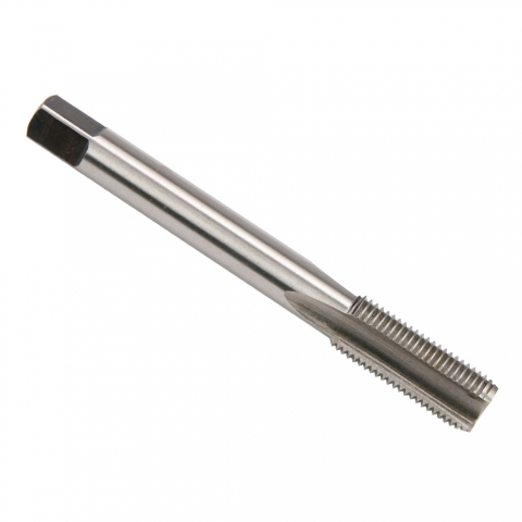

Tap, M10x1.0 Metric Fine, Plug Style, Left Hand
  • M10x1.0 Metric Hand Tap
  • Left Hand Thread
  • Plug style (3-5 chamfered threads)
  • High speed steel (HSS)
  • Metric Fine Thread
Part Number: 3023
Weight: 0.08 lb
Price: $14.95
Hand taps are the most commonly used general purpose tap. They are recommended for tapping free machining steels, stainless steels, aluminum, zinc, and ductile materials.
Plug taps have 3-5 chamfered threads and are utilized in either through or blind hole tapping.
The High Speed Steel (HSS) construction gives good wear-resistance.
This left hand thread tap for the cross slide on the mini lathe.
Tap Type Hand Tap
Thread Size M10x1.0
Class of Fit 6H
Number of Flutes 3
Chamfer Plug
Material High Speed Steel
Thread Direction Left Hand
Thread Standard Metric Fine
Overall Length (Inch) 3.2500" (82.550 mm)
Thread Length (Inch) 0.8750" (22.225 mm)
