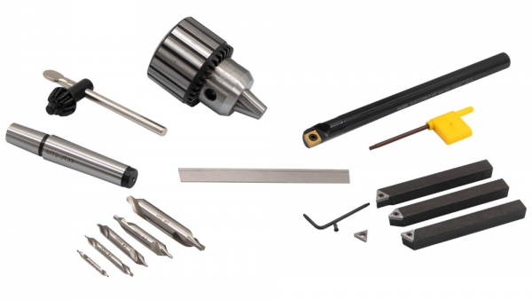

  • Premium tooling package for deluxe bench lathe
  • 1/2" professional grade drill chuck, 2MT standard to 33JT drill chuck arbor
  • 1/2" indexable boring bar - CCMT inserts
  • 3/8" indexable TCMT carbine inserts
  • Premium P1 cut-off blade, 5 center drills
Part Number: 3389
Weight: 3.51 lb
$195.95 Value Price
Purchased individually $221.50
PayPal Credit
*** Current market conditions are causing us to make substitutions in tooling packages that may not be reflected in the above image. Please check contents tab before ordering.
This tooling package contains premium quality tooling for a LittleMachineShop.com HiTorque Bench Lathes. Also fits SIEG C4, SC4 or SC50 Lathes
The 1/2" capacity professional grade drill chuck is mounted on a short 2MT shank for the mini lathe. Specifically designed for the mini lathe tailstock, the rated capacity is 1 mm (0.039") to 13 mm (0.512"). All working parts are hardened. Chuck key included. Number 33 Jacobs taper mount. This chuck is comparable to a Jacobs 34-33 heavy duty drill chuck, including the runout specification of 0.004" (0.10 mm) or less.
Indexable turning tools are made by Arthur R. Warner Co. in the USA. These precision tool holder kits use carbide inserts and include three styles of tools, AR right hand, E Neutral (threading tool - 60 degree angle), and AL left hand. Kit includes three tool holders, TCMT inserts, one extra TCMT-21.52 carbide insert, one extra Torx screw, and one wrench.
1/2" diameter indexable boring bar uses CCMT inserts and is 7" long. The minimum bore diameter for this is 0.625". The boring bar takes CCMT 32.51 or CCMT 32.52 inserts.
The premium P1 parting blade is 1/16" x 1/2" x 4-1/2" and made from M2 HSS by Arthur R. Warner Co. T-shape parting blades provide great side clearance.
Five sizes combined drills and countersinks made of high speed steel. Sizes 1, 2, 3, 4, and 5 with 60 degree counter sinks.
