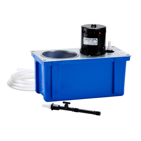

  • Includes tank, pump, nozzle, and 20 ft. tubing
  • Delivers 108 gph @ 1ft
  • Flow can be regulated without harming pump
  • Screen and chip collector easily removed for cleaning
  • 1 gallon polyethylene tank is oil-resistant
Part Number: 3520
Weight: 6.39 lb
Price: $384.95
This LittleGIANT VMC-1 coolant pump and tank unit is great for bench top milling machines and lathes, tool grinders and drill presses. It is compact (the tank holds 1 gallon) and easy to use and clean. The flow can be regulated to any desired amount and even shut off without harmful effects on the coolant pump.

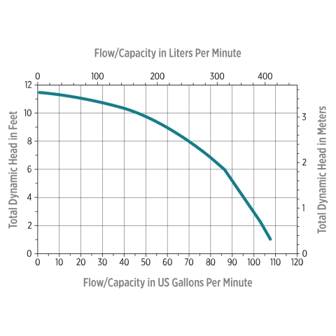

Here are the pump output specifications:
Head
(ft)
Flow
(GPH)
Head
(m)
Flow
(LPH)
1 108 0.3 408.8
3 100 0.9 378.5
6 86 1.8 325.5
9 60 2.7 227.1
Here's the spec sheet for the VMC-1 Coolant Pump.
